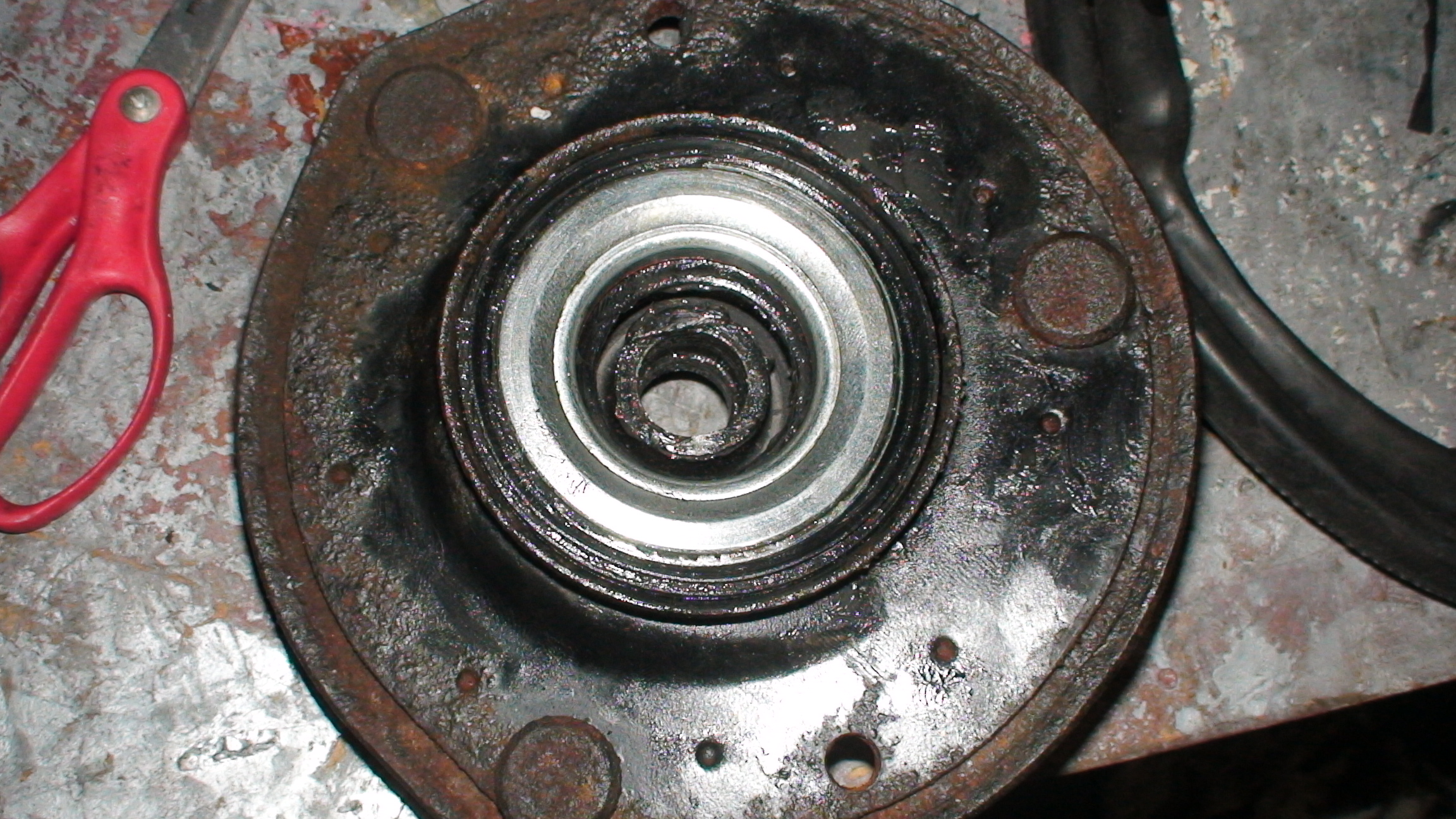

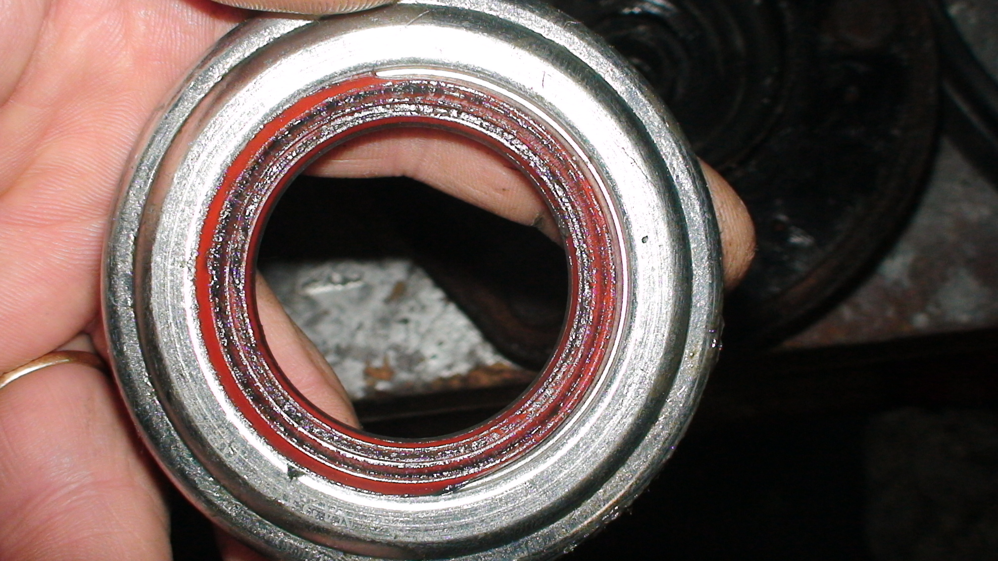

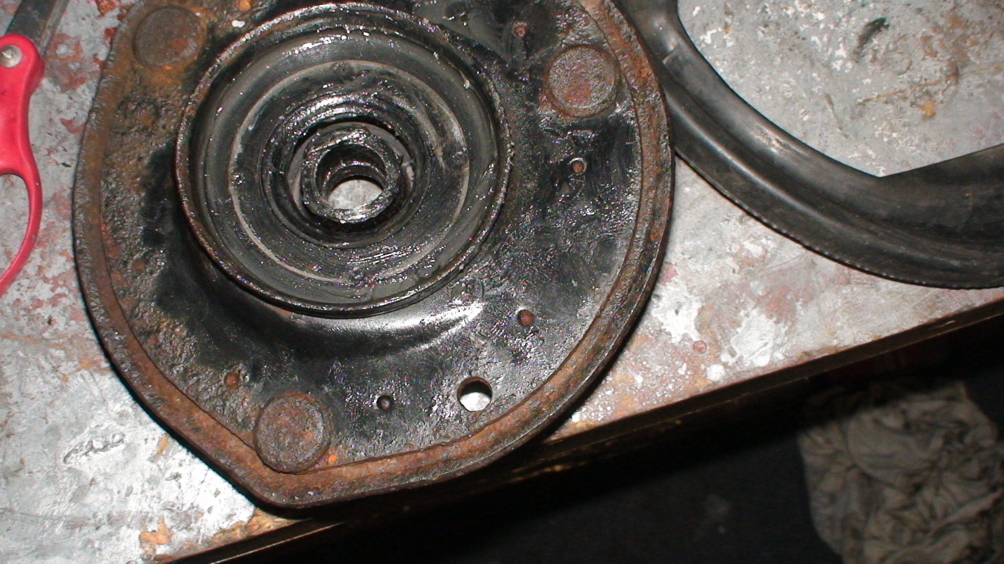

One question, which way does strut bearing which I cleaned and regreased go. Outer rubber lip facing up or down. Can't find any clear picture on the net. Forgot how it goes before removed.

The seal should face up.
If the bearing is upside down the edge of the outer shell (now up) will ride on the mount surface rather then the face as when installed correctly.

Default Install strut mount bearing to strut mount 1995 camry 3.0 liter le
Just including pictures since there is nothing on the internet on the exact way to install not even in a manual from the strut mount part. At least from my search. Also is important to remember how it was removed. OOPS
Attached Thumbnails 1995 Toyota camry v6 le sedan - how hard to remove front struts-dsc02100.jpg   1995 Toyota camry v6 le sedan - how hard to remove front struts-dsc02101.jpg   1995 Toyota camry v6 le sedan - how hard to remove front struts-dsc02102.jpg
