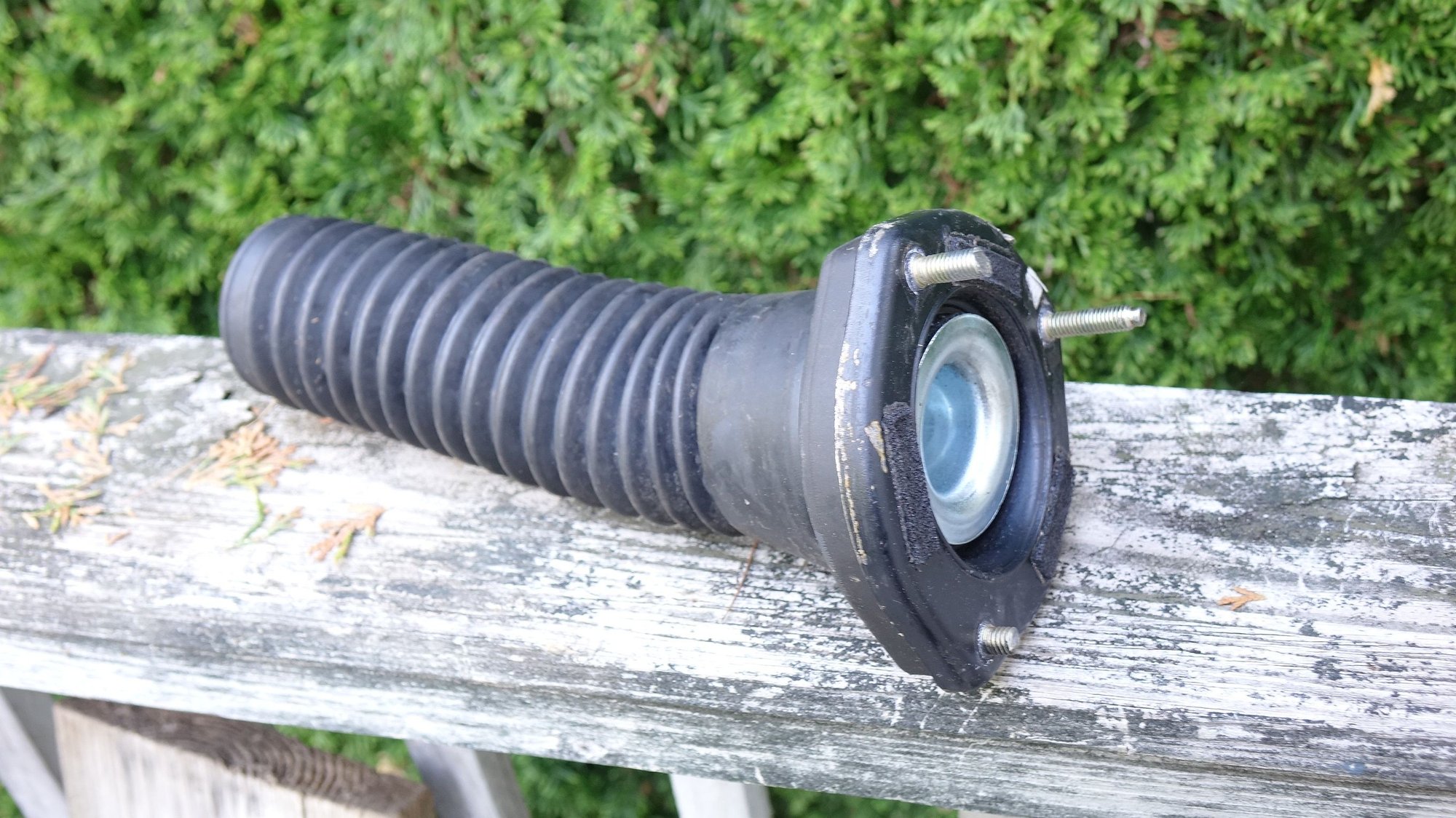

I recently replaced all four struts on my 2016 Camry LE. I used Monroe Quick Struts, got new rear tires, and a 4-wheel alignment.
After doing the rear struts, the parts seemed to fit O.K, but I heard some clicks from what sounded like the top mounts. I overtightened one stud, trying to reach the "recommended" torque of 60 ft/lbs, and broke it off. I got a replacement top mount online, (doing the whole gross routine with the coil spring compressors) and this time, I left the bottom unbolted, and finagled/wiggled the strut around until all 3 nuts seemed well seated before installing the bottom bolts. The spec for the bottom bolts is a whopping 200 ft/lbs, but my torque wrench only goes to 100, so I just tightened hard with a breaker bar. Once I let the car back down onto the ground, I checked the top bolts, and they seemed tight except for one, which now showed about 2 mm of stud under the nut. Tightened it carefully.
The top mounts still make a few clicking noises when going over hard bumps.

They are Quick Struts. I only had to pay attention to the alignment on the one I disassembled. The studs on the top mounts are unevenly spaced, and will go in one-and-only-one way.
On the one I had to disassemble to replace the top mount, I carefully marked the position of the dust boot in relation to the strut cartridge. The top mounting piece is mounting plate/bearing/and dust boot all-in-one.
Both struts make the same noises.
I never touched the shaft nut on the quick-strut that I didn't break the stud on. When I reassembled the other strut, I torqued the nut to 60 ft/lbs.
I didn't notice, nor was I looking for, any markings on the car for alignment of the top mount, since it doesn't rotate unless the spring is compressed.
