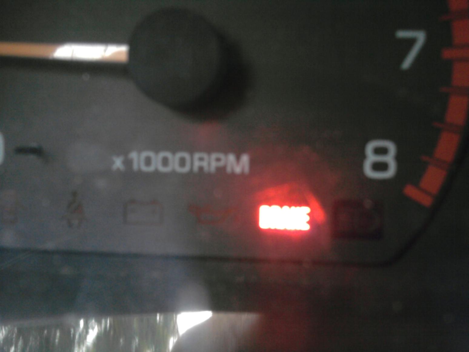

hi, my title says it all. Even with the e-brake down, the dash light remains on. Or is one my brake lights not working? I also have a 87 camry, so this newer car is confusing to me.

check your brake fluid reservoir. if your low on fluid the light will stay on. just fill it back up. next you gota find your leak. brake fluid doesn't just disappear.

i actually did lose some brake fluid somehow. But i did brake light check, and my most right brake light(the tiny one) is out. The easy fix is the light, what kind do i need? Next i'm going to check each wheel well for brake fluid leak. I'm trying to get my car to pass the inspection b4 January when it expires.

Replaced the light, checked the reservoir. The reservoir is full and hasn't changed in level at all. I believe the e-brake indicator is stuck. Now i don't know where that is is. Help!

Fixed the problem! the reservoir's filter was all the way down stuck. I loosened it and that turned off the brake light.
