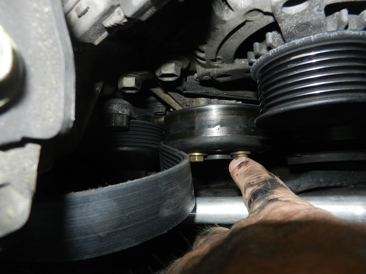

I'm on the phone now with parts co...might drive into town to get parts and fix tomorrow.
There is a 'cowling' that bolts onto the front of the pump. The belt goes over this cowling (I'm sure that's the wrong name for it)
Anyways, you can wobble the part (with belt off) a bit side to side. I put the belt back on, started car and now that I know where to look, you can actually see a bit of wobble in the cowling as it's running.
Parts place just hung up with me, they have the parts on hand.
Tomorrow's project is starting now it seems!
