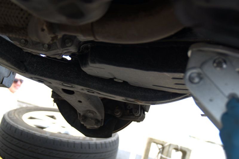

Figure 6. Changing Camry tire.

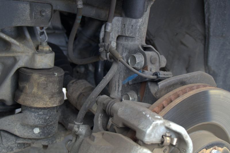

Figure 7. Brake line.
