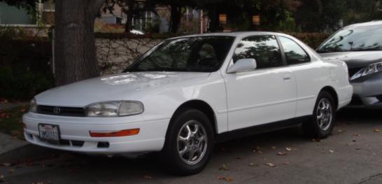

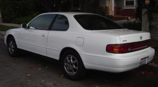

Had the work done at 1-Day Paint, the national chain. White. You never want to do a color change on a car. Unless you like surprises.
The car glistens like a jewel. There was no body work except for about 6 'dimples'. For $725, I would give them a B+ on the painting, and a C on the dimples. You can still detect ripples where the repairs were made. Visible when sighting along surfaces.

You're miles ahead if you can stick with the old color. When you change, all the crevices in open cavities become a nightmare to paint. Under the hood, door edges and frames.
And on resale, the buyer will suspect that you had extensive body damage in an accident. Seriously effects the resale value. Can't you live with fresh paint/same color?

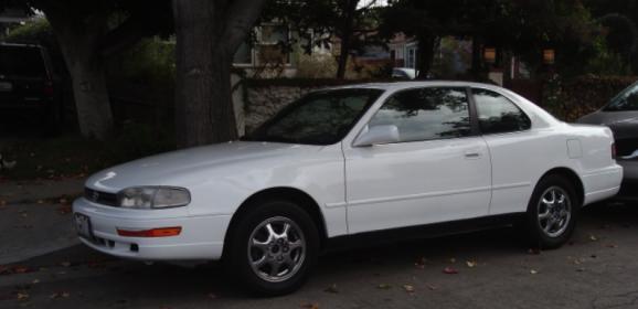

Having learning problems with digital camera. This clearly isn't working, as uploads continually fail. Photo taken under foggy sky.
The paint is flawless. Urethane. But have to wait 90 days to rug out (polish) and then wax. I'll practice more with another digital camera and take some new photos.

Difficult to tell for sure from the pics but I'll take your word for it, looks really sharp from what I see. Did they give you any guarantee that it would last?
As long as the proper prep work was done to insure that it sticks, I'd be very happy with the cost and outcome.

The paint is backed up by Sherwin Williams and by One-Day Paint. We just had our first real rain of the year in Southern California so I'll wipe it down and spend a more time experimenting with the sole dorkey digital camera in the household so I can post more photos.
As I mentioned earlier, the paint won't be cured fully until the 90-day mark. Then i can rub it out with a buffer and I'll post more shots. That will be in 60 days.

Nope on door jambs and trunk, etc. That's why I chose not to change colors.
I honestly don't know if they would accept me doing light body work. They might back off on offering the guarantee with an unknown clod prepping before the paint is applied. I was a little dissatisfied with a tad of overspray on the radiator and air dam in the front. A bit sloppy, but not crazy.
