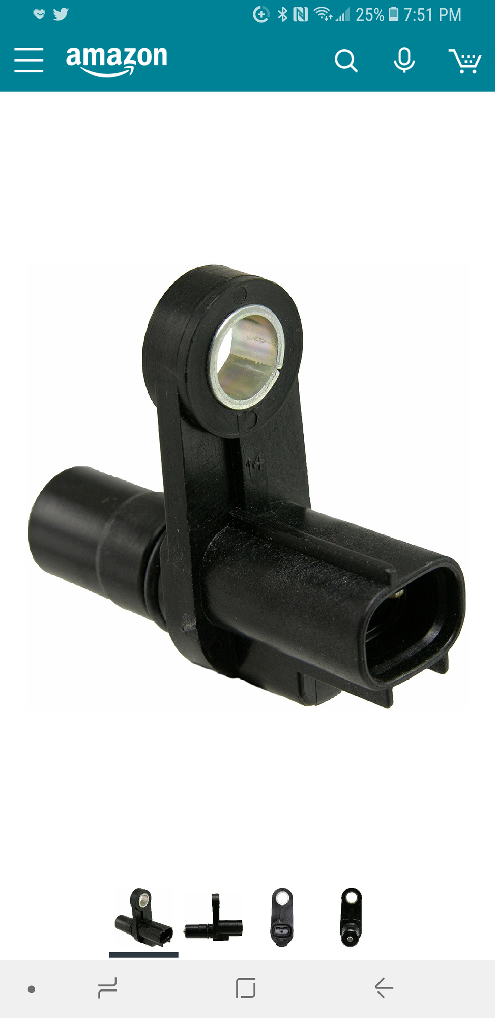

So my 98 Camry stopped getting into gear and started throwing p1705 on my reader. I replaced the transmission speed sensor that has a gear in it but there is a second sensor pictured below.
where in God's name can I find this on the the transmission??!

Automatic or manual Trans? V-6 or 4-cylinder?
The part in question is located on the differential portion of the trans. Look down at the engine from the front of the car. Then look to the driver side of engine where the trans is. The differential is located on the firewall side of the trans.
Find where the drivers side axle shaft enters the differential. Follow an axial line off the axle shift over the top of the differential. The sensor is located on top the differential along this line.
The round part of the sensor fits into the differential housing. The sensor is bolted to the housing via the hole in the arm coming off the sensor. The sensor will have a wire cable running to the oval end.

Code P1705 is NC2 Revolution Sensor Circuit Malfunction (Direct Clutch Speed Sensor). This sensor is for picking up rotation speed on a clutch pack hub connected to transmission input shaft from engine.
The photo's appear for the speedometer sensor.
Based on your symptoms. It "appears" the trans has either internal problems such as failed clutch, brake, torque converter system or low fluid/plugged up trans oil pump intake screen.
It appears the clutch hub having the sensor is rotating, but the car is not moving. The result being the NC2 sensor shows rotation and the speedo sensor which detects differential ring gear rotation (axle rotation) does not. This could set the P1705 code.
Check trans fluid level. Try shifting trans manually through all gears including reverse.
