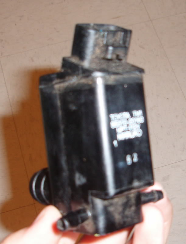

Hey,
I just replaced the windshield washer pump on my 1996 Camry wagon and ran into some major problems with finding the right pump. The pumps that are listed (which there are 2)for a 96 camry are not the right ones for the wagon. It took me a little digging and some help from a guy at a toyota surplus but I finally found the right pump and I wanted to let everyone know what the proper part number is. I think this would apply to 92-96, but I'm not sure. The correct part number is 85310-20160. Plug that in and it will get it done. Good luck. By the way this was a very easy project, aside from needing to remove the tire and the lining of the wheel well, but all in all only took about 30-40 minutes.
