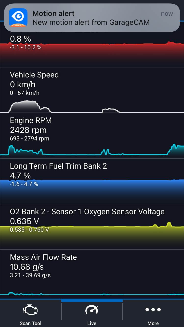

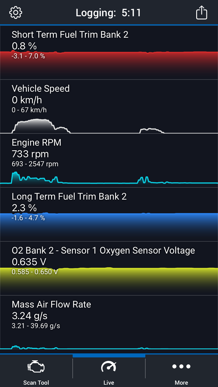

California emission. What's interesting to note regarding this P0171 issue, is that after a few minutes of warming up while driving, the Bank #1 Long and Short-term fuel trim levels are not as high and seems to drop from 50% to 10%.

Do you have Bank 1, Sensor 1 voltage info?
Does the scanner read coolant temp? If so at when temp does the trim drop?
