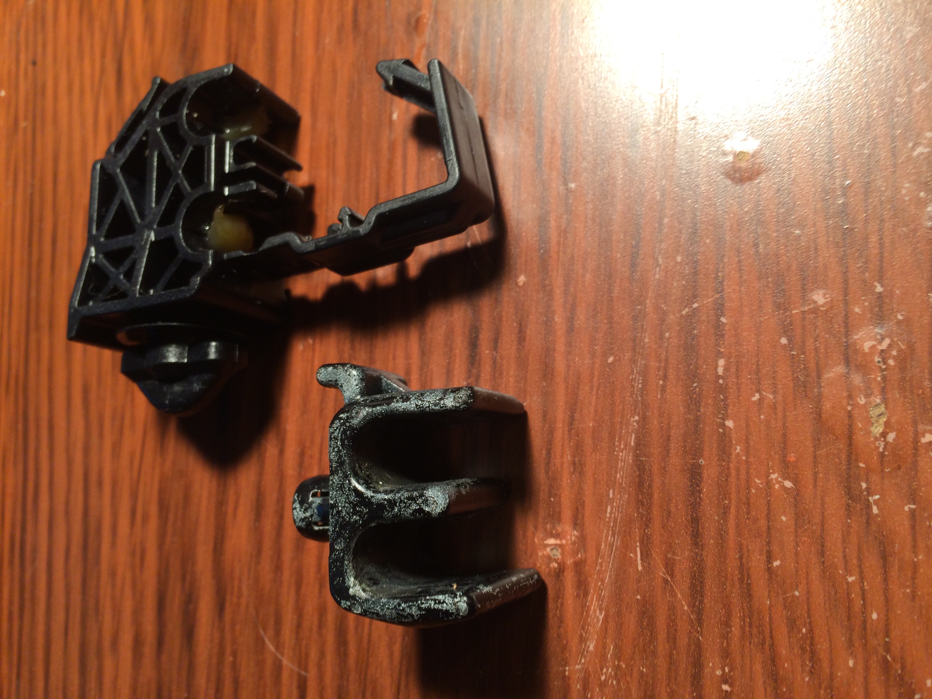

I just received the new torsion bar clip or support and it looks different from the original. All torsion bar clips exist for 1997 and up but not for below that year.
Trying to figure out how to make it work with the new one.
See picture. Newer one is larger piece. The smaller one pushes in a hole but does not hold tight and bars slip out. There may of been a plastic bolt on the end. Not sure.

Temporary Repair
Inserted the old torsion bar bracket to the trunk frame and pushed in torsion bars to channels. To ensure it does not pop off wrapped the bracket, torsion bars to trunk frame with a narrow hose clamp and screwed it tight.
Torsion bars do not rub against strap and lubricated torsion bar channels.
So far works fine but after driving I will see if the strap is still secure.
Even though this was not the part it did show me the manufacturer lubricated all channels with grease since torsion bars go back and forth. Mine may of broken since it had little grease.
