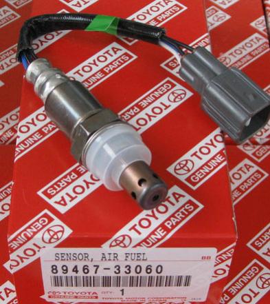

I googled this part and found it on EBAY for $119.99. This is similar to an o2 sensor.
I saw this on EBAY for sale for $119.95. OEM GENUINE TOYOTA/LEXUS ES300 2001-2006 CAMRY AIR FUEL RATIO SENSOR 89467-33060
"The Air Fuel Ratio Sensor continually tracks how much oxygen is funneled into your car's engines' cylinder. It's similar to an o2 Sensor, but does a few things differently." Are these really $500.00?

The design of the air/fuel ratio sensor (A/F) is an improvement over an 02 sensor but both do the same thing. The A/F sensor however is able to operate over a much wider range of air/fuel ratio's then the 02 sensor having a very narrow range.
A wider range sensor allows the engine computer to better adjust the air/fuel ratio.
The A/F and 02 sensors are not interchangeable.
Unfortunately an engine has more then one sensor, perhaps up to 5. These sensors can be a mix of A/F and 02 sensors and have different mounting systems such as bolt-on flange or screw in base.
Plus a car may have built to pass California or Federal emissions standards for which different sensors are used.
Thus one A/F sensor does not fit all.

Sensor prices vary, the Ebay part is a great price. Retail dealer price might be $210 which still leaves $300 to account for in the quote. A bit steep if only one sensor is being replaced.
If you are going to do the work yourself and the part replaced has a screw in base suggest purchasing a special socket. This socket has a cut out on the side wall to allow the wires to fit through when the socket is installed onto the sensor body.
