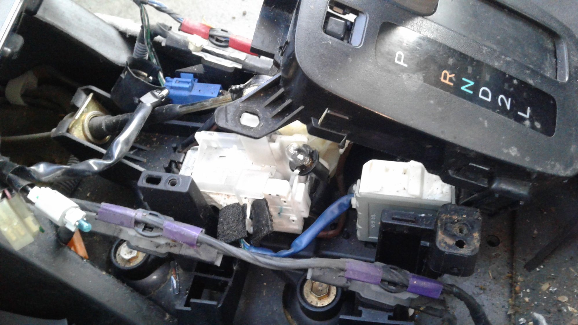

So I went to Pick n Pull to see if I could get a shift lock solenoid for my Camry. I took off the center console, but I am a little unsure of which part is the solenoid. It does not quite match the view that the Haynes manual provides. I am uploading a couple of photos that I took.
Old Dec 7, 2020 | 05:42 PM
Shift lock is on located on passengers side of shift lever. Its location is about as forward towards the dash as the shift arm is when in park.
