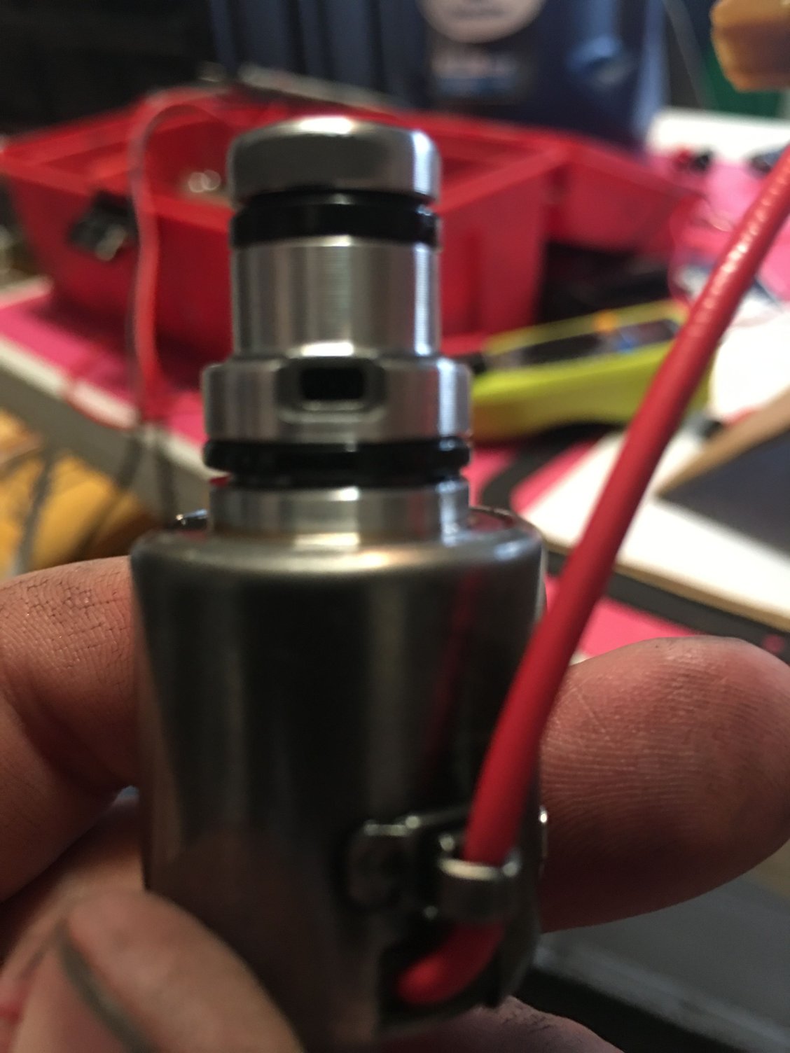

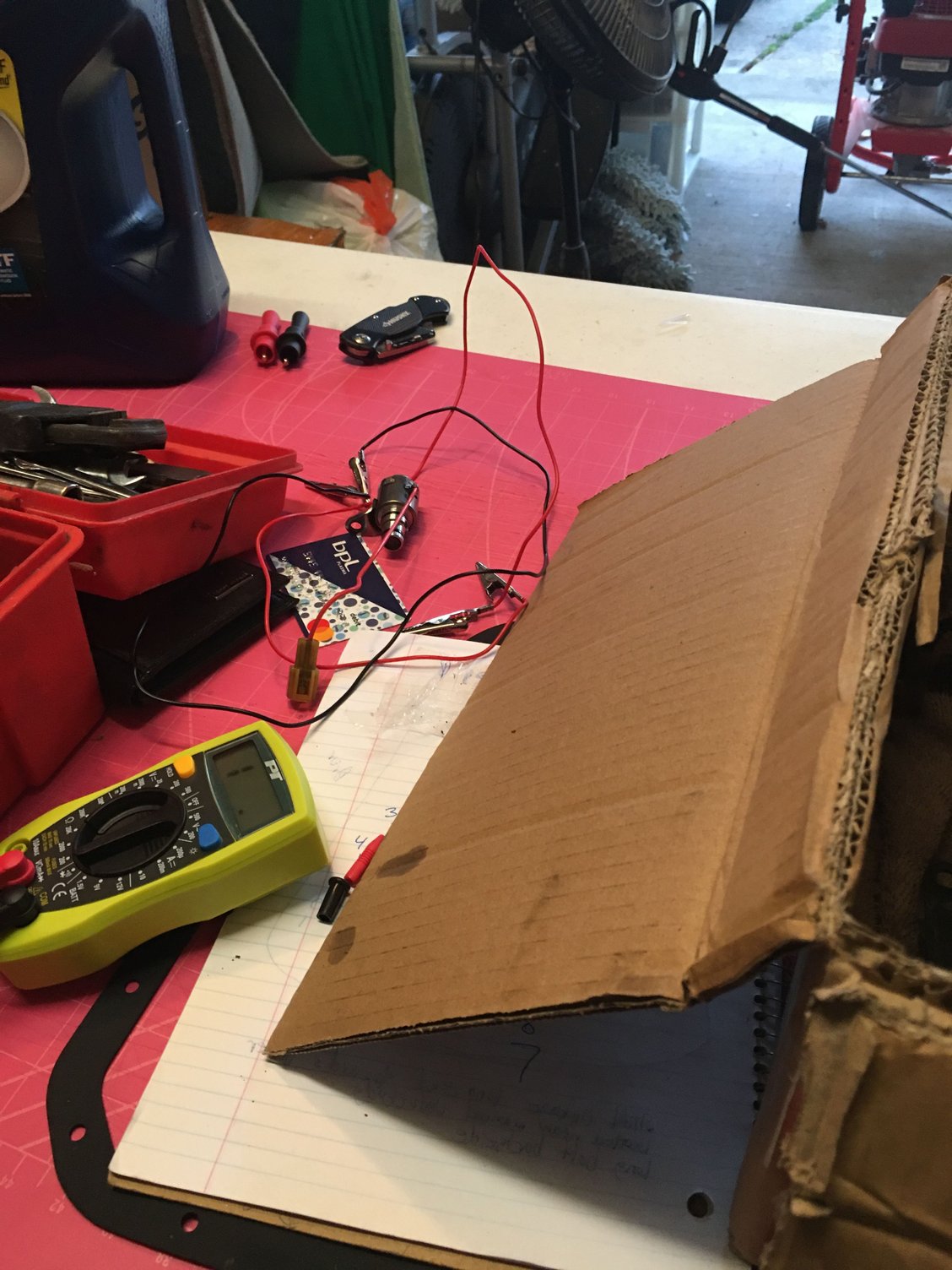

so I removed the valve body and the solenoid is clicking and the ohms are at 13, but when I’m clicking the solenoid with my battery I don’t see anything opening or closing could this be the fault?

I don’t know if this particular solenoid is supposed to open and close “lock up solenoid” but I don’t see anything moving inside when I test it could my transmission control module be bad?
Old Oct 21, 2020 | 02:26 PM
Toyota has a diagnostic check for the solenoid using compressed air.
See private message for more info.

I changed the lockup solenoid and nothing was fixed I tested all solenoids while valvebody was out and they were all operating properly now I’m aiming at transmission control module would this module act up this way? Other than that I don’t believe my torque converter is bad this car was driven properly it’s whole life.
