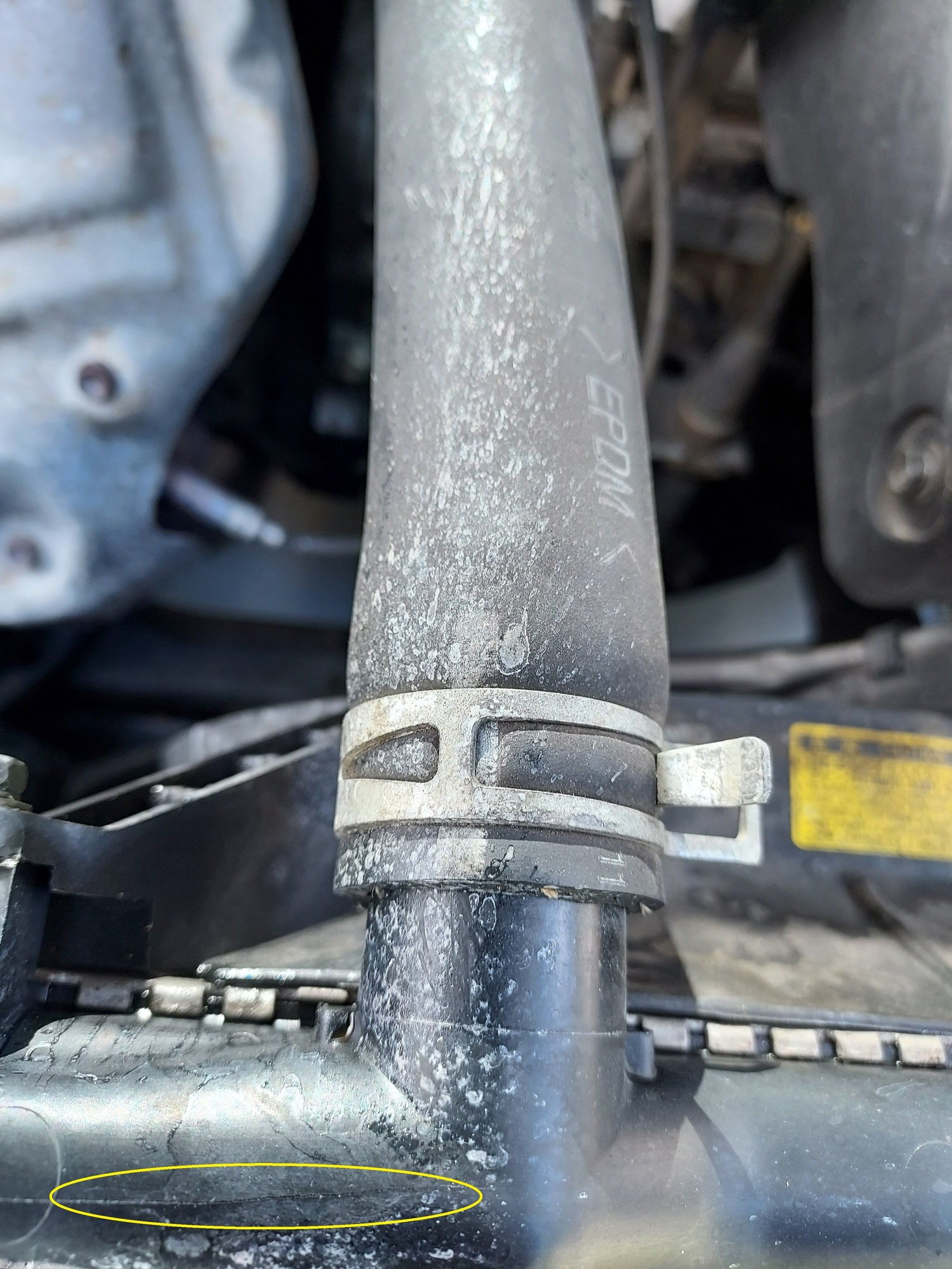

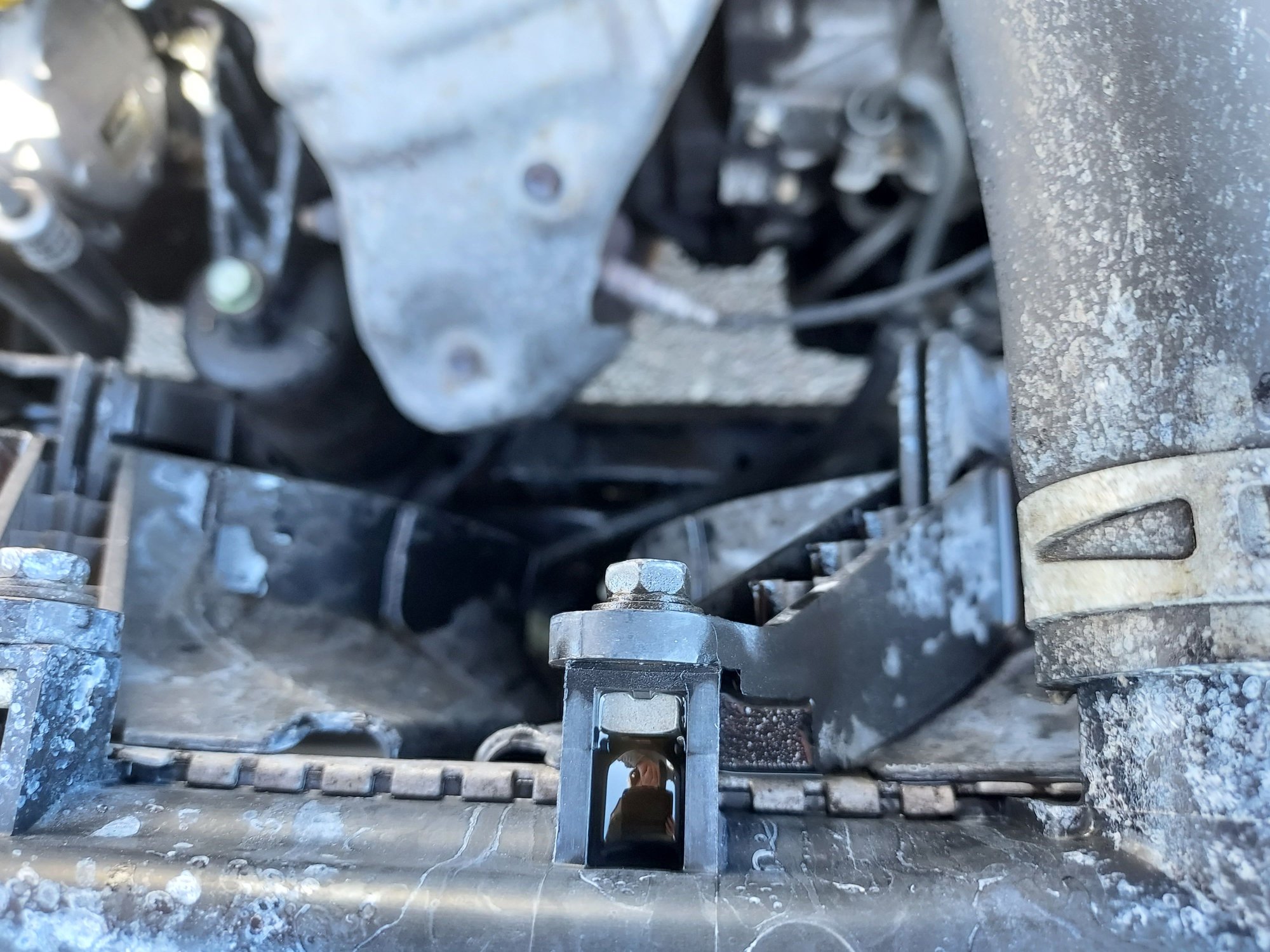

Before I left to go to my mechanic (Shawn)'s house, I topped off my radiator with distilled water. After traveling 2.5 miles, My temperature gauge almost hit the H (hot) line. I pulled over in a Bimart parking lot, and called him. He came to me. He visually saw that my radiator is cracked. He put in more distilled water and some coolant and we took a drive for 10 minutes with going 40 mph and the needle stayed in the middle range. We got back and popped the hood and he could see there is a crack in the radiator and it was dripping coolant out of it. He walked across the street to Albertson's supermarket and bought black ground pepper and put some in my radiator. It actually did help with cloging the leak, but I need to buy new radiator and upper hose that leads to the rad.

Having been down this road with almost the same year car.
DON'T add coolant system sealant or pepper. They both can plug up things.
If your coolant is now leaking out in large amounts DON'T keep adding the coolant mix. Water by itself cools very well. The race cars on TV use water because if they get into a wreck that damages the radiator there are no environmental issues.
DON'T bother to fix any crack on a plastic radiator. The fix might work for a time, but it will eventually leak and perhaps worse.
If you are trying to drive to the closest mechanic, leave the radiator cap loose. Tightening the cap will build up pressure and force out the coolant faster through any leaks.
DON'T leak the temp gauge get into the red. This can blow a head gasket or crack the head.
If the cars A/C system works, turn it on high. With engine idling both coolant fans should turn on/off with when the A/C compressor clutch turns on/off. You will know when the compressor is on because the engine RPM should rise slightly to compensate for the load of the compressor
There is a radiator fan on/off temp switch on the lower part of the radiator which faces the engine. Unplug the wiring harness from the switch. If the fan system is working OK both fans should come on.
The fans typically only operate when the car is idling or in stop and go as in slow MPH. At normal road speeds the fans should be turned off as the is now ample air flow through the radiator.
The KOYOGUARD should be OK. Get a radiator with a guarantee as had them leak. If buying at Rockauto look at the Denso brand. Toyota owns a large stake in Denso.
For radiator hoses any of the brand name listed in the Rockauto Daily Driver section are OK. If the hose is moving and not swelled up in size it may be the clamp. Get a hose clamp that has a screw tightening mechanism using a screwdriver.

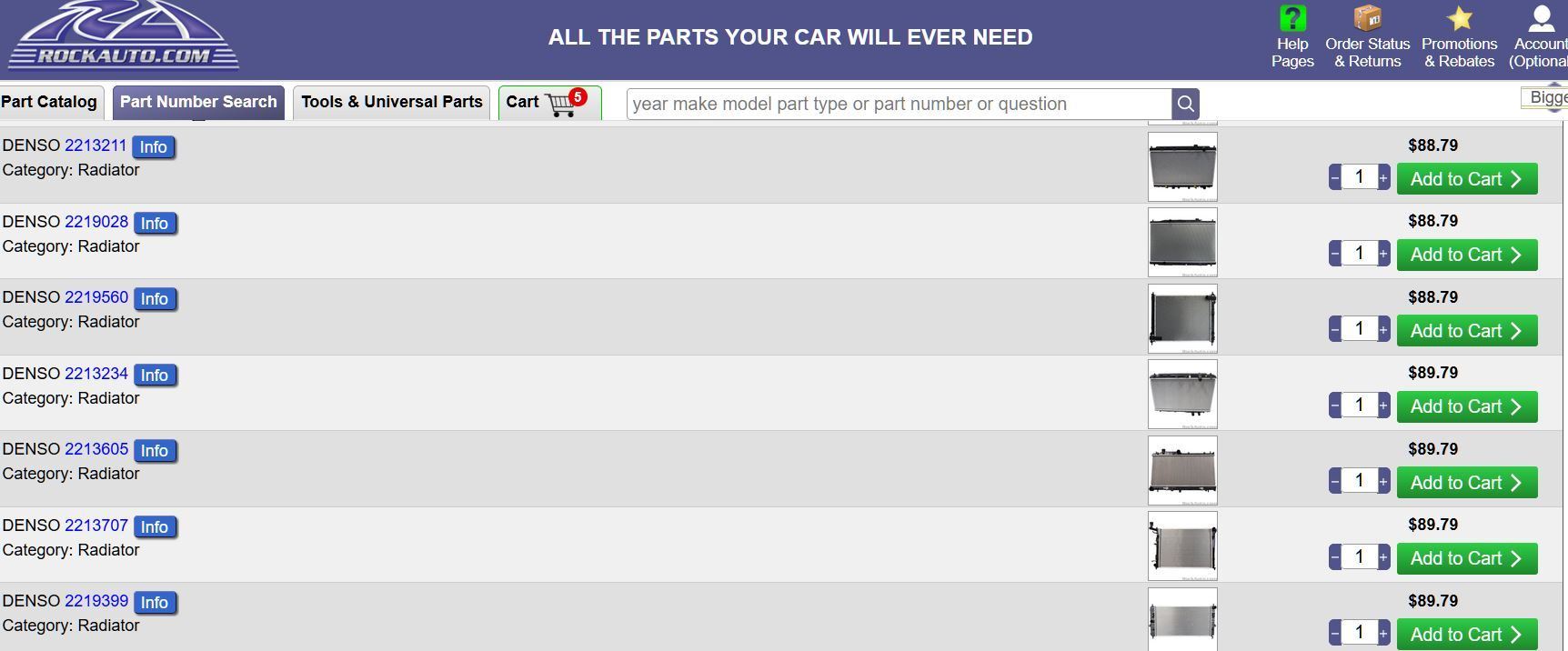

Can you find me the Denso radiator? I deleted the KOYOGUARD one. There are pages of Denso radiators. Here's just one page.

DENSO2213131
Confirm it is the right part by reviewing your cars info is correct at the link below.
1996 TOYOTA CAMRY 2.2L L4 Radiator | RockAuto
The heart next to the part listing means it's a popular selling part.
Search the internet for 5% off discount codes on your total purchase. Put code in the checkout box asking, "where do you hear about us?"
Which shipping chargers on multiple items as the company drop ships from warehouses across the US and charges can add up.
You can tell which warehouse the part comes after you put it into your cart. it will have a symbol of a truck and letter such as A, B, C each being a different warehouse. As stated any name brand of radiator hose will be OK.
Rockauto takes some patience to get everything you need a reasonable shipping cost. The win is part prices can be 1/2 that for the exact same parts (brand and part numbers) as sold at an auto parts store.
