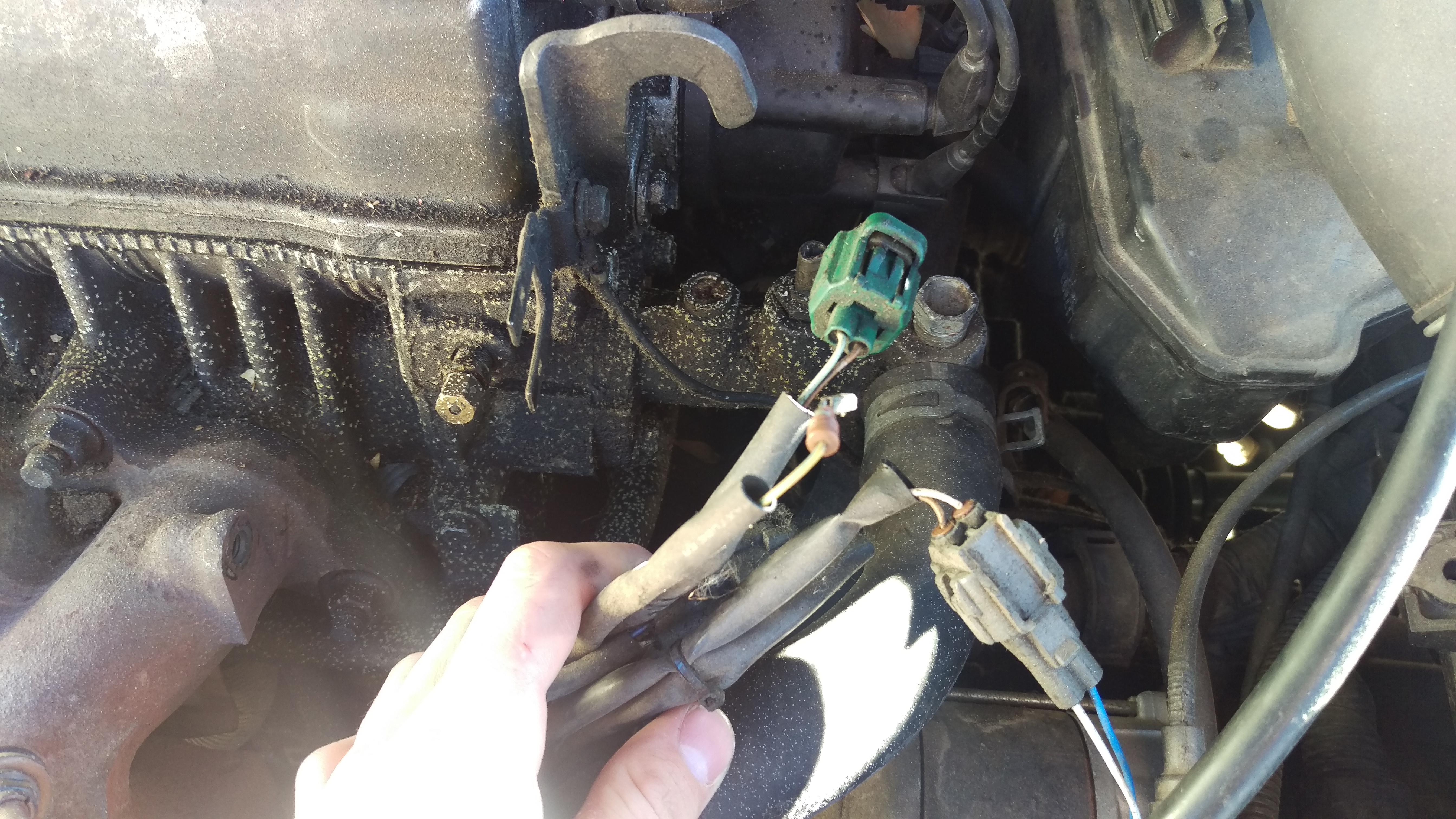

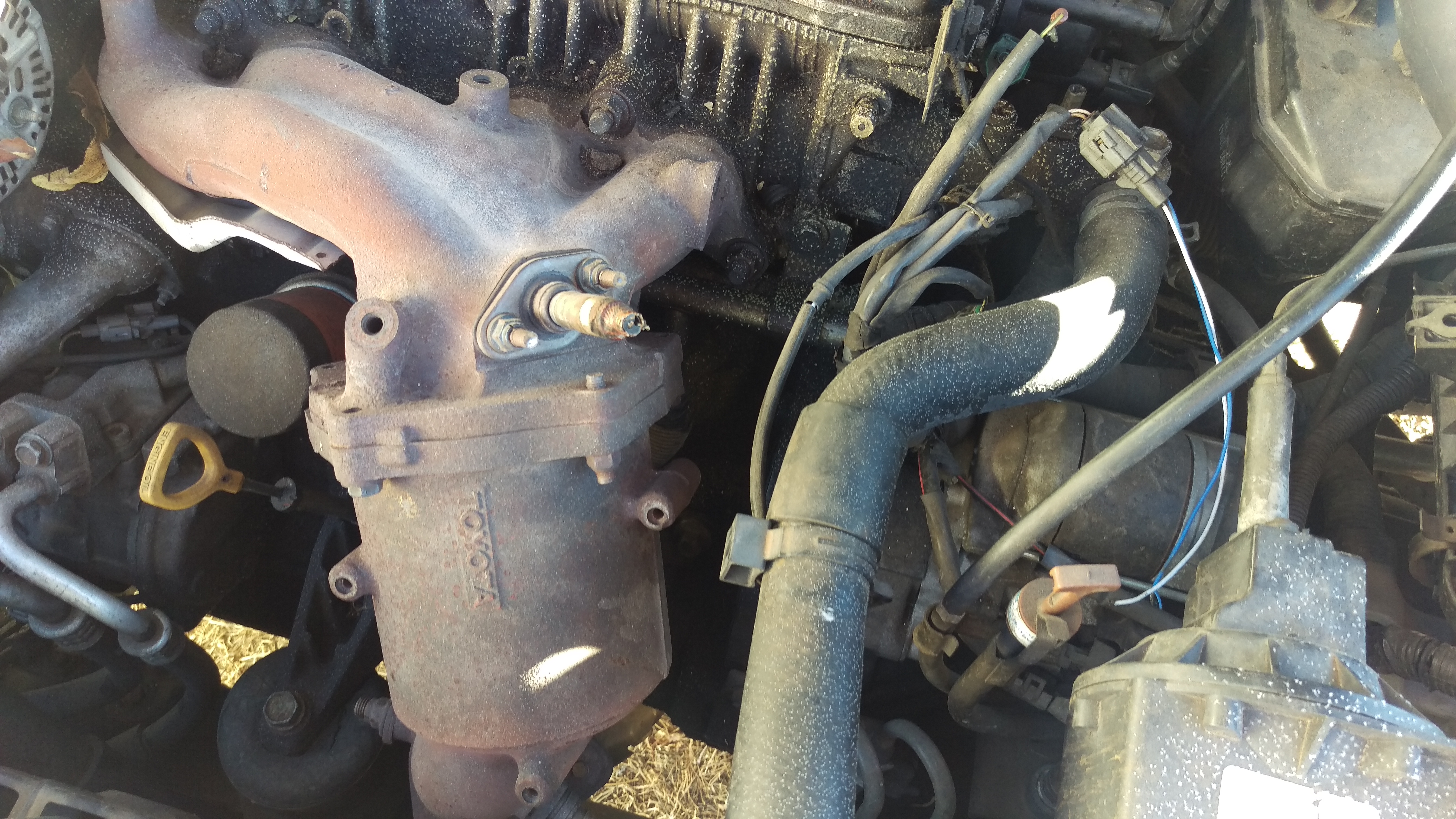

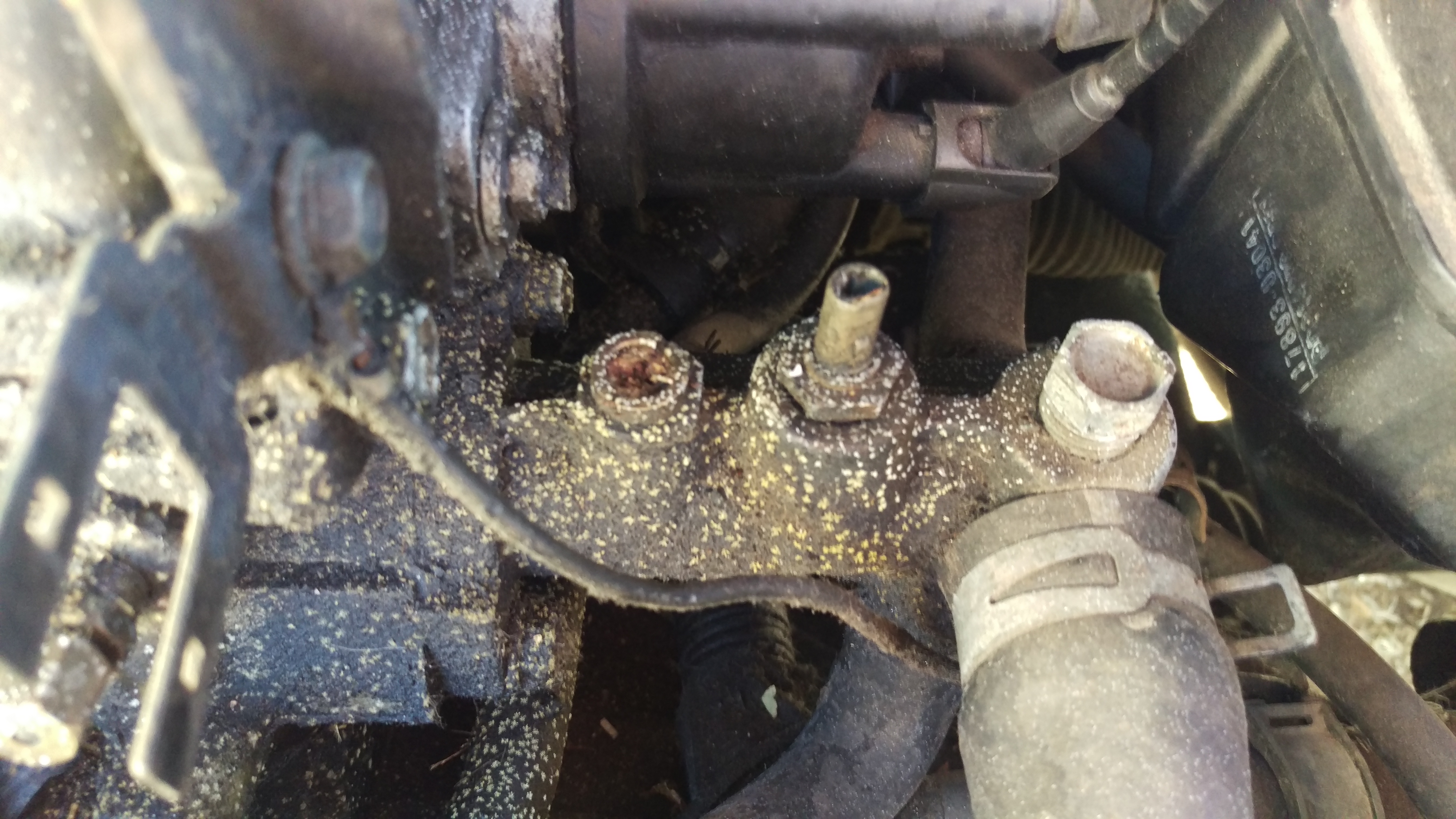

I haven't been able to get the car to start in the past 2 days. I noticed while going over the motor that not only is one of the 2 o2 senors broken(the top one, which is what i believe to be the second o2 sensor), the temp sensor and whatever sensor is right next to it are both broken (all three sensors the wires are broken off) could this be the reason for the lack of power, and now it not starting??
also does anyone know what that second sensor next to the engine coolant temp sensor is??

Old Dec 5, 2016 | 10:00 AM
Kimber4268's Avatar
Joined: Dec 2016
Posts: 15
From: Del-Norte CO
The white spots are from it freezing last night. Right now it is currently 19 degrees here

Old Dec 5, 2016 | 10:56 AM
Kimber4268's Avatar
Joined: Dec 2016
Posts: 15
From: Del-Norte CO
Also there is an extra plug in that bundle that isnt going to anything, but then i saw this plug looking thing, what is it exactly, anyone know?

That is your oil pressure sender (in red). I suspect your oil pressure light is on all the time now.
You have a bit of research in front of you and probably a trip to the junk yard. Some of those wires that are not connected will cause some issues. I forgot what each of the other connections do but they are obviously there for a reason.
Check for engine codes as you work through it so you can see when they go away. You probably should get a Haynes manual or subscribe to some service for a few days to get the information you need.

one of the sensors is an ect (engine coolant temp sensor) and is a huge problem. it tells the motor if its hot or cold, and right now the ecm thinks the engine is running really hot, even when its frozen haha,
i found out the car will fire right up when it is warm. so im guessing that sensor is like an automated choke for the engine, and is causing the vehicle to run really lean
good news is I'm probably making 40+ miles to the gallon
the second sensor is a temp sender sensor and just tells the dash gauges what temp the motor is, so it doesn't mean much mechanically
the large one on the exhaust is an oxygen sensor and combined with the dead ect sensor is probably(hopefully) causing the vehicle to run like it was made in the 1800's.
its that fourth little sensor (the one in the red circle) that I couldn't find anything online about, if its oil pressure then I'm not worried, even tho it has only one wire going to it
I have done ALOT of research today, but please if I'm wrong on any of this correct me. The way it sounds, I just need to replace four sensors to fix this power issue, to bad the o2 sensor is 100$+
my ability to make money right now has nearly halted but I'm working on replacing the sensors this week
hopefully I will soon have an answer as to whether this is the cause
If anyone has any ideas let me know

"its that fourth little sensor (the one in the red circle) that I couldn't find anything online about, if its oil pressure then I'm not worried, even tho it has only one wire going to it"
Yes, you are correct. One wire goes to that one and it is for your oil pressure.
