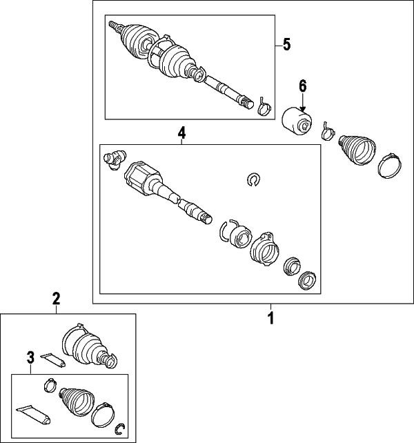

i have noticed all aftermarket CV's dont have the damper thing in the middle some kinda weight i guess. i was wondering if thats why everybody reports vibration on acceleration? what you guys think. look at #6 in this picture
Good question.
Donuts dampen vibration, typically high frequency which can over time damage bearings and CV joints. Experts state if a new axle came without one it does not need it.
Have noticed many after market axles used thicker drive shafts which may be one reason no dampener.
As to what to do? If the old and new shaft are not the same diameter may have a problem installing it. At minimum this would require taking the axle apart. Then were to locate the dampener as Toyota lists a specific location on their axles.
Have never bother to add the dampener to replacement axles.
Also look into EMPI/EMIRE axles.
