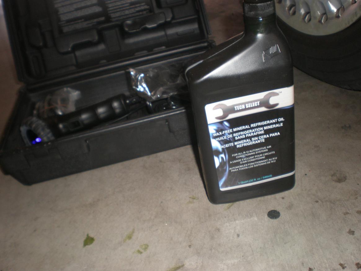

here is what i did
i rented 134a dye injector machine for low side ,from autozone .
90.00 on card and you get reimbursed when you return the tool.
kit comes with small 134a to r12 aluminum fitting adapter
then i went to napa and bought r12 mineral oil (one quart) $9.50
i flushed the green dye out of tool best i could, because other people rent the tool it has dye residue .
i filled the 2 oz. reservoir on the injector with mineral oil and started car and turned on a/c . low side vacuum started and draws oil into compressor as you rotate the injector slowly .
i used leather gloves to grip slippery stainless injector
Attached Thumbnails 1990 camry dx 4 cyl automatic / air condition oil ?-auto-zone-rental-dye-injector.jpg   1990 camry dx 4 cyl automatic / air condition oil ?-auto-zone-rental-dye-injector-kit.jpg   1990 camry dx 4 cyl automatic / air condition oil ?-r12-mineral-oil-quart-napa.jpg

Old Aug 11, 2011 | 11:03 AM
Posts: 15,178
Great job!
The oil amount is correct the lower amount was for an condenser change.
