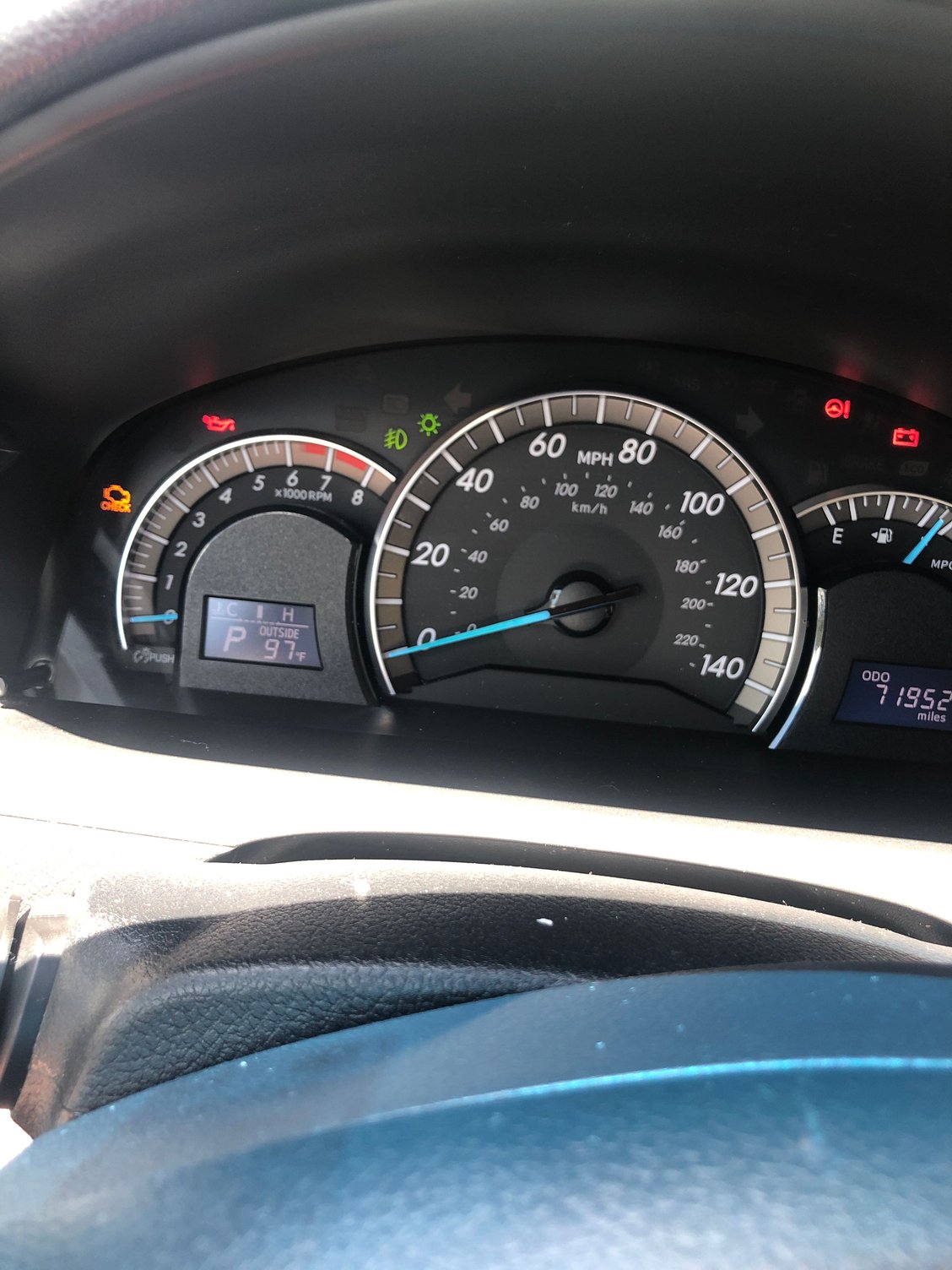

Hi, we have a 2021 camry se 4 cylinder. 77k miles. The car started having issues few months ago. It died at a stop light. After it died we could not start it again. The check engine is constantly on. The car will spin over but will not start. We took it to the dealership and they said it was a bad 12v battery. After the replacement of the battery the car seemed to work just fine for 1 month and started acting up. So we have kinda narrowed it down. When the car stalls, the only way is to disconnect the 12v battery and reset everthing basicly. afterwards the car starts and runs with no problems but within 15miles it happens again. Its happening more often now and yet still no dtc. Its extremely hot in houston. Any help would be appreciated

Hi, yes the check engine light is on when the key is turned to the on position and when cranking the car. I have a generic scanner and it shows no codes. I just went to get the battery and charging system tested and they say the battery is good but voltage regulator in the alternator is bad….still trying to see if this is related to the issue. I don’t know how to check for Toyota priority codes

Hi, I bought an obd2 reader only and it shows no codes. Weird thing is that it only happens when the car conditions are hot. Not as in the thermostat hot, it is normal operating conditions. The temp outside is hot, like 95-100 hot and the car has been running for awhile. It died today just sitting still in park with ac on. Of course couldn’t start it back up, it’s spinning over as normal. Had to disconnect the 12v battery and then connect it back on. Once that was done the car started and ran like normal

The car never dies while driving. Only when at a stop or in park.
outside tempt is 95-100.
engine coolant is normal temp.
when you disconnect the battery of course everything goes off like it should. When reconnected the car starts fine and runs fine til the next episode.
I’ve tried checking it with a cheap obd2 reader when the car does, but no codes are showing.
Very weird case. It’s like when you are disconnecting the battery it’s resetting not only the codes but something else. Then everything works like normal.
