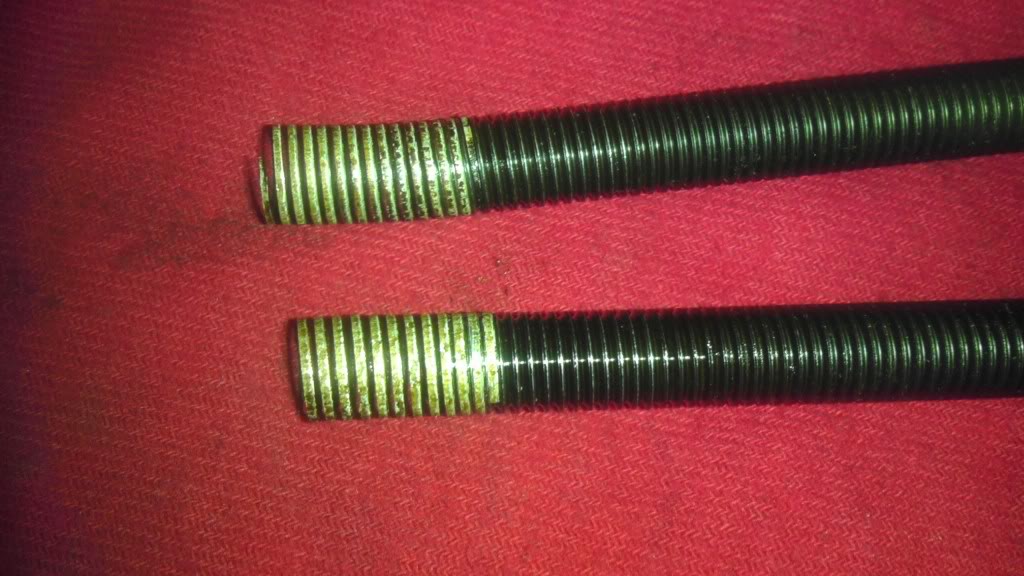

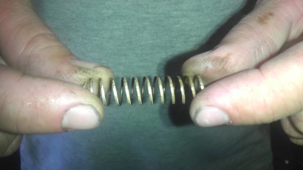

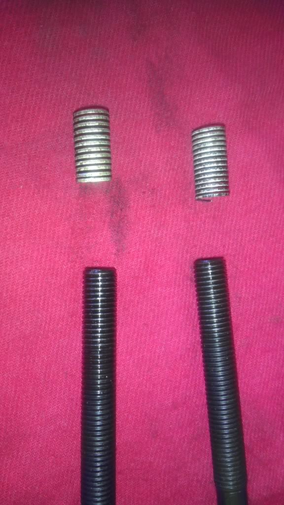

This theory may have been discussed in another thread so my apologies if that is the situation.
I just saw this problem for the first time today. Same 3 bolts. The mechanic showed me the bolts and something very strange was threaded on the bottom of 2 of the bolts.
You could thread them off and on and they were identical spring like pieces Same height and diameter. They would compress and stretch just like springs.
The third bolt did not have it but there was some trash at the bottom of that bolts hole.
The OD of the springs were flat and were the same as the OD of the bolt thread. There are still threads at the bottom of the holes in the block although the bolt is very lose when you thread it in. Very interesting. There is no doubt in my mind that these are worn heli-coils.
The question is when they were put in and who did it?
The car only has about 85k on it and was bought with about 75k. All posts seem to indicate this problem manifesting itself at a much higher millage than this. The repair of the 3 bolts could have been performed before it was bought but I don’t think so. Can’t prove it though.
However, I do have an alternate theory.
Fact 1: There has been absolutely no plausible explanation as to why these 3 bolts and only these 3 bolts fail. Not one.
Fact 2: These engines were manufactured in multiple plants.
It makes more sense to me, given the above two pieces of information, that one plant had a problem with the boring or drilling operation during the production of these blocks: specifically problems with these 3 bolt locations. Too many blocks had been produced to just trash them, so they did a mod with the heli-coils
That just seems a more plausible explanation given the lack of any other cause of failure being offered.
t's a 4 cyl, 2002 and millage is closer to 100k but that's still considerably lower than other testimony here. I still believe these were factory mods from the same plant. However, who's to complain when your engine fails at 130,000 miles?

Helicoils are threaded both inside and out, and are made of stainless steel.
So I can't see how they would break smooth with the outer edges of the headbolt threads.
More likely the aluminum block would break off and you would pull the bolt, with Helicoil still attached, and aluminum coiled in the Helicoil's outside threads.
Helicoils may also be magnetic, but a coil made of aluminum most certainly would not be. Did you check if those coils you took off the headbolts were magnetic?
The theory behind just those three headbolts pulling is:
"The foam insulation used to protect the plastic intake manifold from heat is causing overheating in that center area at the rear of the engine block, thus causing metal fatigue. Allowing the aluminum threads in the block to break off, and those three headbolts to pull loose."
I am an original owner and there were no factory installed Helicoils found in the block when my Camry was repaired. Only aluminum coiled in the headbolt threads, that looked identical to the photos you posted.
My camry had 155 K miles on it but I still had the block repaired using NS3000L inserts, at a total cost of $1000.
The car just passed 183 K miles and it is running fine. So it has cost me an extra 3.5 cents per mile since the repair. And that gets lower with every additional mile.
Money well spent I believe.
