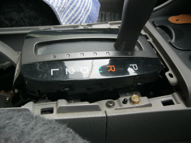

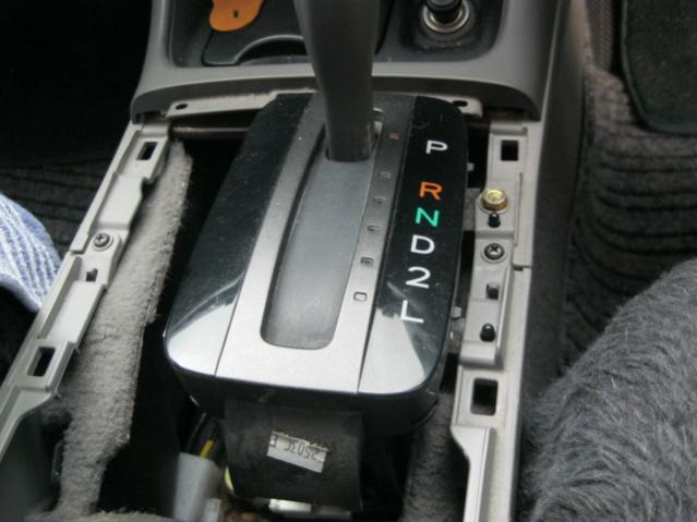

Thanks for your feedback, your instructions were spot on. The console top came off in about 5 seconds. What I found when I removed the cover is the shifter seems to be in a sealed case. There are what look like clips on the outside of it but I am not sure what to apply pressure too. Pics attached.
Thanks again for any feedback
