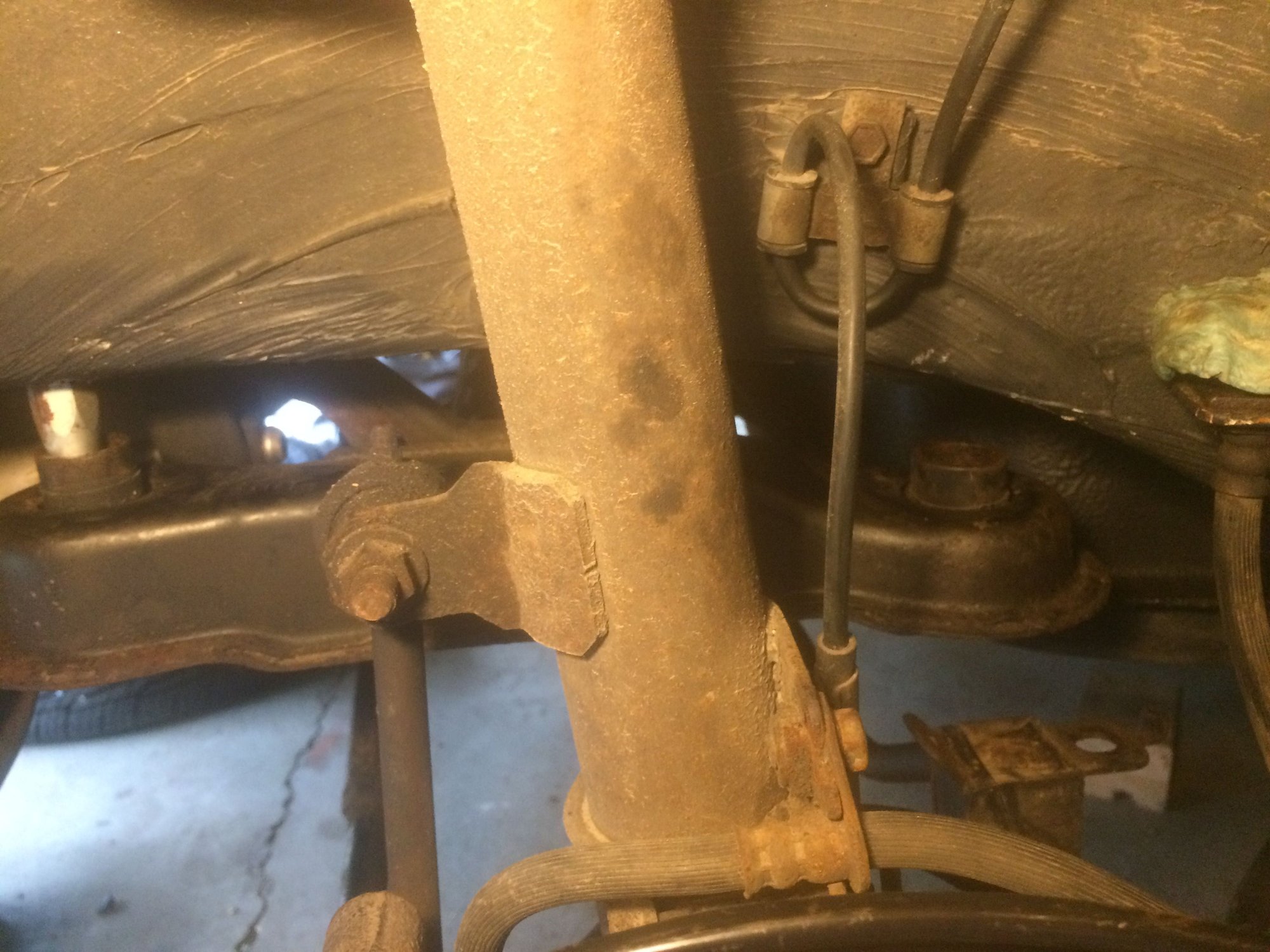

Removed the brake lines but in the process broke a stabilizer bolt which I will drill out and a suspension crossmember bolt (rusted bad inside and broke).
This section had to be removed to remove brake lines on both sides. Fortunately it screwed off from frame and did not break. See pictures.
Removed both nuts to remove bracket for brake line removal. The nut on the back did not breaks off. .
My question is since these bolts are easy to get at why not replace the bushings.
It looks like they push in from the bottom. It also looks like there are only lower bushings since the top is a steel ring.

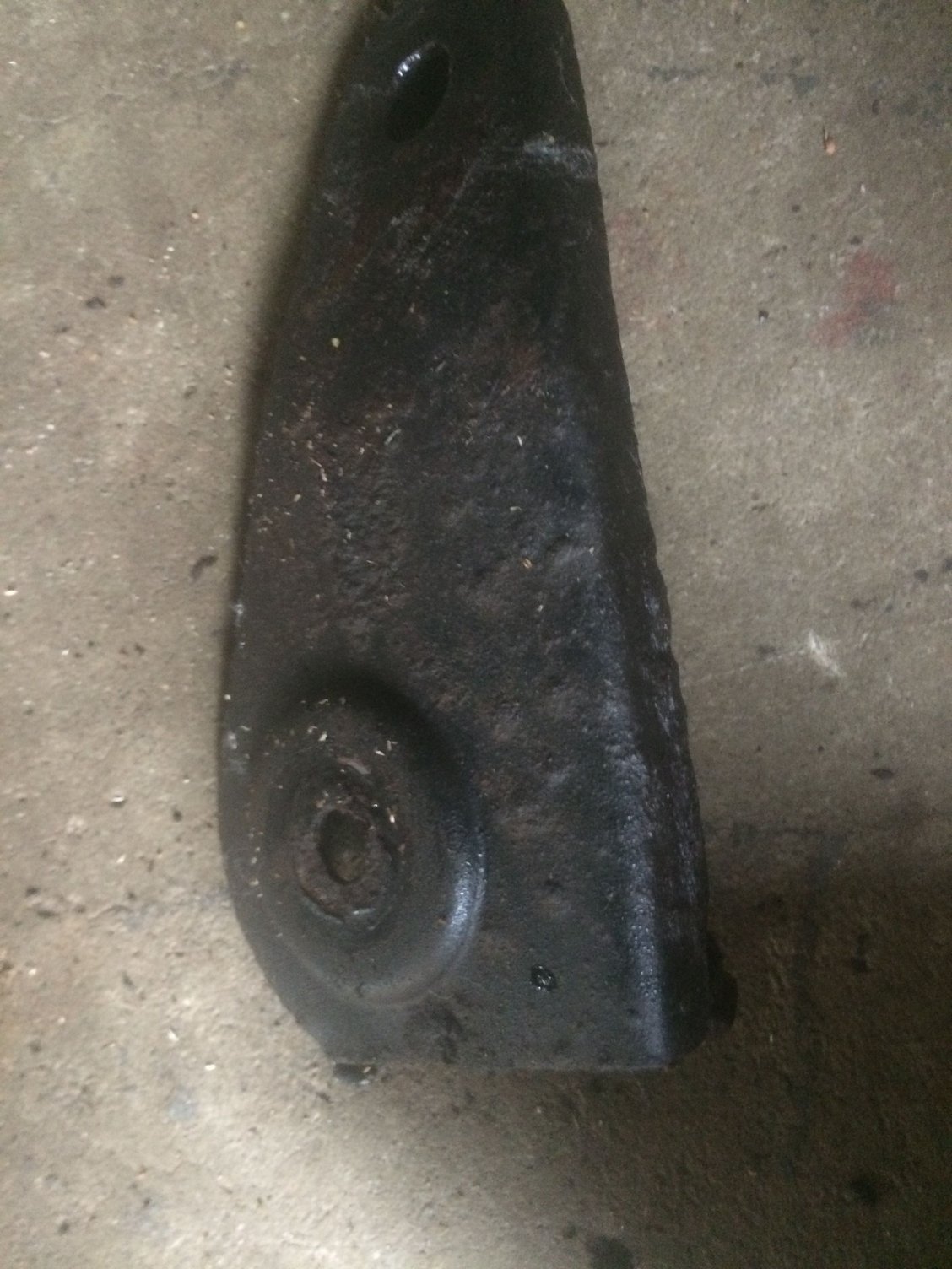

Old Jun 16, 2019 | 04:44 PM
Is this the part or it's opposite side member?
https://www.toyotapartsdeal.com/oem/...257-33010.html
Opposite side is P/N 51024-33010
The bolt (stud) broke off this part?

Here are the pictures of the passenger side right rear side where nut broke off stud that holds cradle but was able to remove stud.
The previous picture is where sway bar bolt broke off and need to drill out from drivers side bracket but broken stud is from right side.
First picture You can see passenger side rear cradle with left stud intact and right stud missing since nut broke off stud and then unscrewed stud from body.
Second picture = Close up of cradle with stud missing.
Third picture - New stud on display.
Other picture - Bracket that holds sway bar and cradle in place.
Old Jun 17, 2019 | 02:32 PM
Where did you get the new stud?

90109-10142Suspension Cross member bolt.
