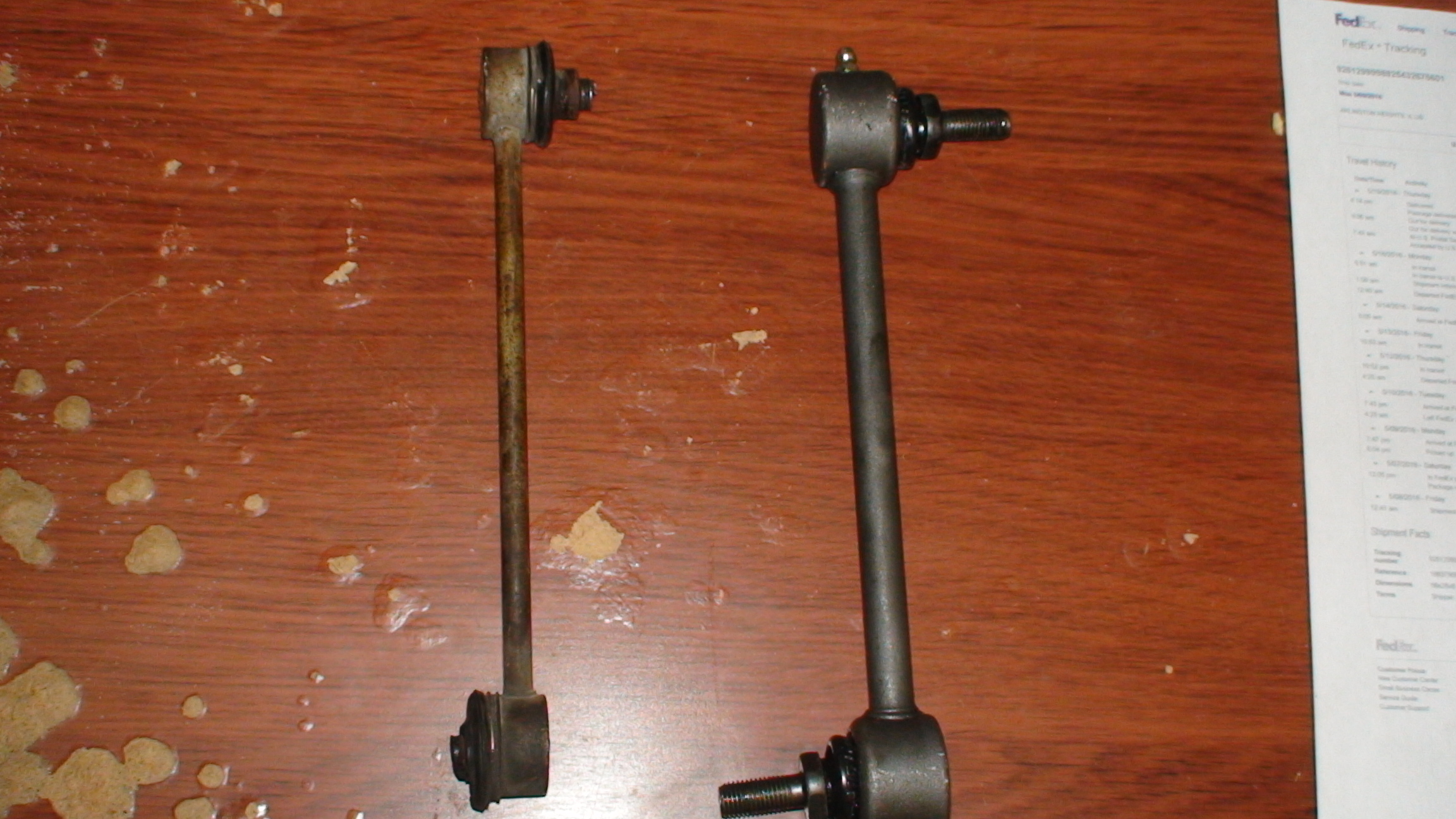

I think I should replace my rear stabilizer bar link. I can grab it and turn it back and forth but not up and down. I feel I can remove it with enough force. Likely never changed.
