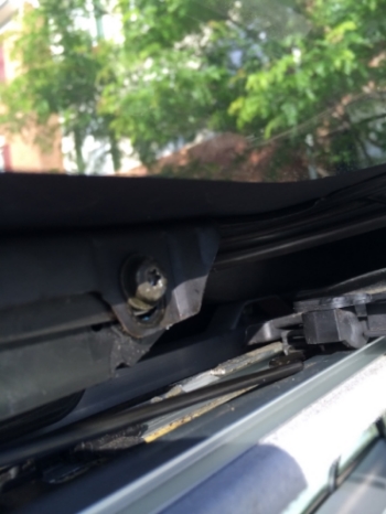

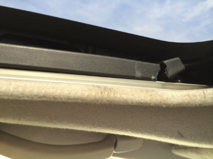

Hi I have a sunroof repair question and I am new to this forum so I don't know where to post this but my sunroof is open it won't close or open. The motor and the sunroof glass is fine. I think the only thing broken is the black tabs that pull the silver tray and the black metal at the sides. Here are the pictures.

Do you see the right side with the black metal it's on the ground it's not hooked up do I need to buy a replacement for that black part to? I have come to a price of $131.28 for the parts( 6 parts) I think I need. The 2 black bars or cover that pulls the metal for for the sunroof cover. the 2 black metals 1 side that is broken and I forgot the other 2. Please tell me if that is the right pieces needed.

I'm no sunroof expert but it looks like you have some things figured out pretty well. Sunroofs can be finicky and a real pain to work on. I take it the electric motor runs just fine when you hit the button, just nothing happens, like the glass is not engaged in the track?

Exactly what you said. I can hear the motor working but no action. I have an 2003 toyota camry and I would like(need) to know if those are the parts I need to buy because I am going to take it to a shop afterwards to get my sunroof repaired.
