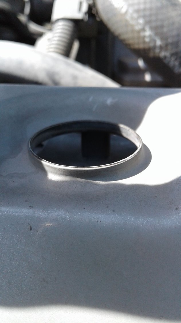

Upper core support 2005 V6 Camry.
Just bought a Camry for my daughter and discoverd the radiator was loose.
Shouldnt there be rubber grommets in the core support holes and the top tank pins centered in the grommets?
Would anyone happen to know where is the best place to look up online toyota parts?
Thanks.
Old May 13, 2018 | 10:48 AM
Upper insulator?
Try looking under P/N 16523-0A020.
Ebay also sells them.
https://www.ebay.com/p/TOYOTA-Oem-ra...A020/663127462
