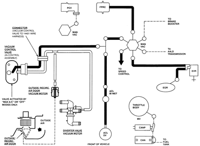

Replaced the vaccum switching valve and pulled the vacuum lines out with the valve... i now have no idea where they go and think i may have broken the lines. anyone have a vacuum diagram for a 98 camery 4 cyl?

I cant find a 98 layout
a 96 4 cyl any help
Attached Thumbnails 98 camery vacuum lines-2a4b72e.gif   98 camery vacuum lines-104d8cb.jpg

Thanks! Got alot of it figured out so far still have a super bad rough idle though so either new egr is bad. New vsv is bad. Or vac lines still messed up
Old Sep 9, 2016 | 11:42 PM
The vacuum to the EGR valve should be off when the engine is idling. The VSV should also be venting the vacuum hose to the EGR to atmosphere.
