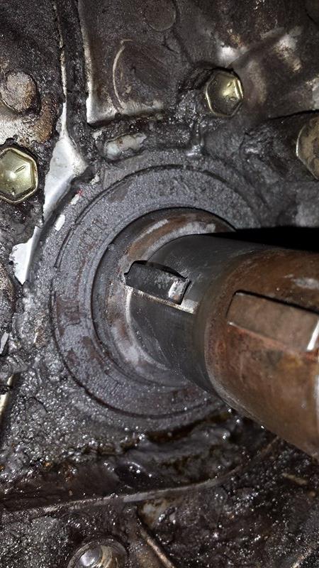

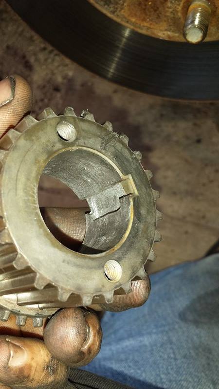

I think I figured it out. I don't know how I missed it before, but the crank gear is bad. The key beat a new hole about 1/16th of an inch. Explains why my timing looked correct but acts a tooth off. I'm going to order a new one and get it installed and i'll let you know how it works. Thanks for the help!

so what went with that??? i jus came across th same scenerio: 99 camry 2.2 - timing belt n water pump last summer (belt broke but pump was leakin so it all needed to b done anyhow), coil packs left us broke down, replaced 1 thn th other jus recently, but it wasnt th 2nd pack, i thought th water pump was about to explode in pieces- in my stethoscopes it sounded like a rolling cage of broken metal pieces- i swore th water pump was shot although no overheating probs or anything. i order another timing belt n pump kit n NOWWWW i come across tht lil crank gear like u jus pointed out here... final conclusion was thts GOTTA b my culprit... im about to order a gear- did u have to order a new key? how do i get oem factory size on th key tht belongs in there? i havent been able to find a part # yet... its my wifes daily car n shes driving my camaro until its fixed... help a bro out man lmao!!!
