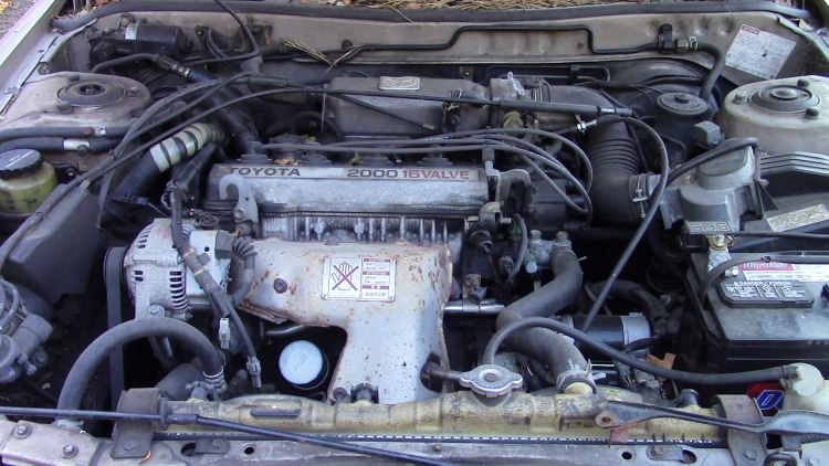

the car may have blown an important fuse causing it not to start
your picture two
the plastic thing near the battery terminal has 3 fuses
check none of them are blown
then check all the interior fuses
if all the fuses for the car are ok
you may need a replacement engine management computer .. called an ECU

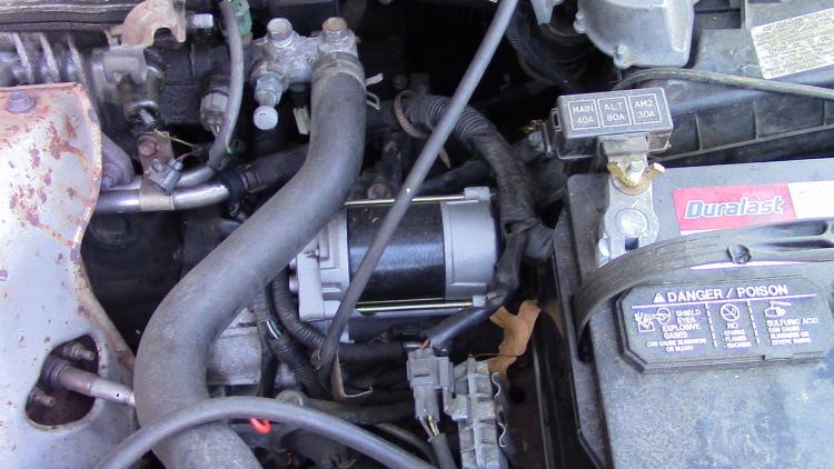

The ALT 80A fuse is welded in place, we are assuming that this means something fried it so hard that it is now part of the fuse box itself. We tried to get it out and it pretty much fell apart and the bottom half of it is stuck in the fuse box. Not sure what to do now because we wouldn't know how to replace the fuse box if we can't get what's left of the fuse out. We might not be able to check back for a few days to a week or so as my surgery date is coming up on Thursday of next week and I will be in the hospital for a couple of days.
