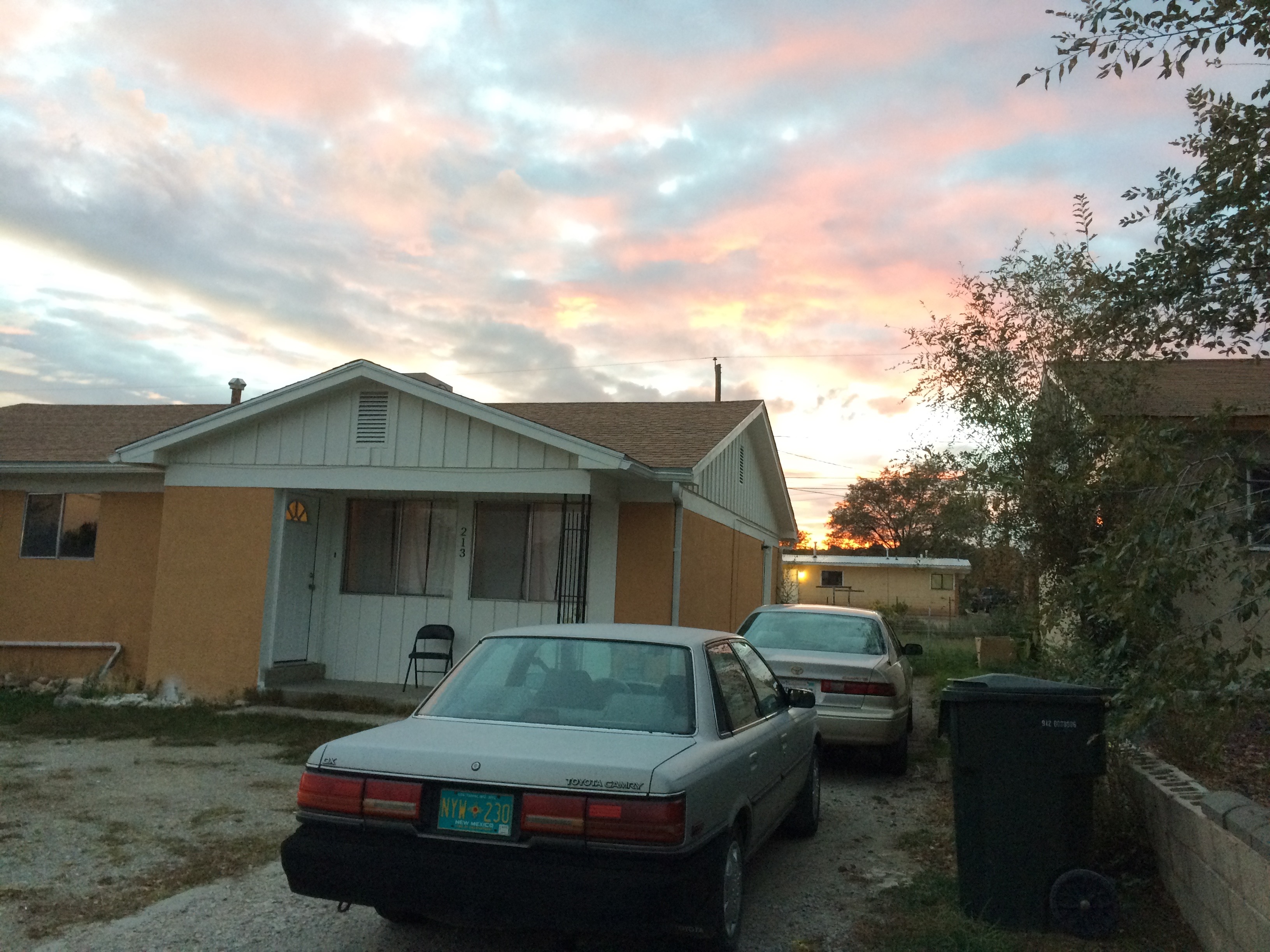

Although I've browsed these forums before, I've just today created an account and hope to be able to contribute to and learn more from the great resources here.
We currently have two Camrys in our stable: a '98 CE 2.2 5-speed with about 275k and a '90 DX 2.0 auto with about 217k.
The '98 I bought in 2010 with about 160k after specifically searching for a 3rd or 4th gen with the 5SFE and 5-speed manual. I ended up finding a CE base model, manual windows and locks and all, that was properly maintained and it has turned out to be the best car I've ever owned in terms of reliability & build quality, and as a major plus its also one of the easiest cars to work on that I've seen. Always gets 32mpg+ on the highway and still rides very smooth with no creaks or rattles. Idles perfectly and is every bit as powerful as the day I bought it. All the window and door seals are still holding up strong, no wind noise with the windows up, etc. I'm impressed on every road trip how comfortable and efficient a of this age with this kind of mileage can be. Other than routine maintenance and timing belt replacement at 250k, the car hasn't needed much and the only unexpected failure was the oil pump at somewhere around 220k (it was the original). I plan to keep this car on the road for as long as it is willing, and from what I can tell that will be a long time still and well in excess of 300k.
The '90 I just bought at the beginning of August for my partner and we've put about 8k on it since then. A change in her job meant needing her own transportation, so I began the search for...another Camry. We had a very small budget and I looked around for a while hoping to get lucky with a 3rd gen but ultimately found this 2nd gen in really good shape that drove nice and straight and had a lot of major items replaced within the last 5k miles. The downside was it had been sitting for a while which meant it needed new tires and some fluids changed out. At $800 I decided to pull the trigger. I immediately changed the oil and had the tires replaced since I was driving the car from San Diego to New Mexico, and crossed my fingers that everything else would be okay as long as I took it easy. Turns out the alternator died on me during this first trip (which was a whole crazy experience that I'll have to write about elsewhere), fortunately on these cars its easy to replace, and O'Reilly lets you borrow tools thank goodness! Since getting the car to NM, I've replaced the radiator hoses, thermostat & coolant, and replaced cap/rotor, spark plugs and wires. Still planning to drain and refill the transaxle and differential, and a few other things on the list. However, on our last trip returning from California a more pressing issue presented itself which ultimately resulted in us getting towed back home the last 97 miles. I'm quite certain its a fuel issue and will be trying to get it figured out this week. Basically the car started sputtering under anything more than very subtle acceleration (but cruised just fine and climbed just fine as well so long as the overdrive was off). When we stopped it didn't want to start easily and once it did it would sputter as soon as it was put into gear and asked to accelerate. With very gentle modulation of the throttle I was able to get it back on the highway several times (where it once again would cruise fine every time), but eventually it failed to start back up, fortunately within range of home that we could get towed by AAA. So that is my project for this week, I'm going to start with the fuel filter but may be asking for some help from you all if that doesn't do it!
I realize this turned out to be a long post and I'm not sure if anyone is still reading, but if you are...thanks for reading! I'm glad to have finally joined the forums here and look forward to giving and receiving help regarding these great cars!
Cheers!
-Andy
