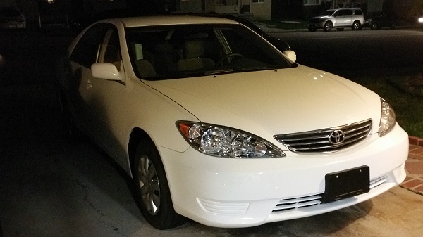

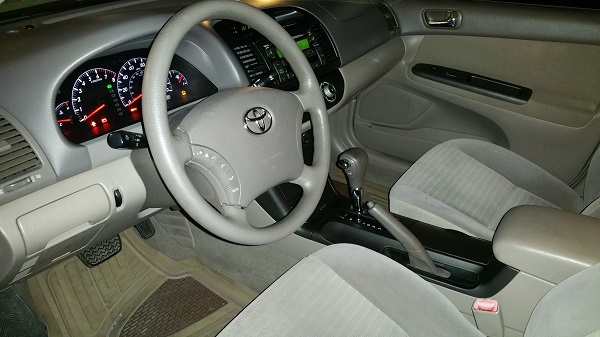

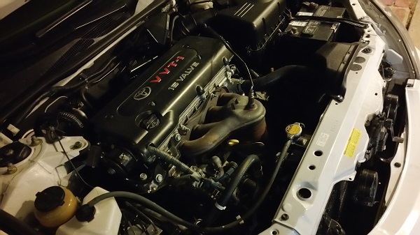

Very kewl welcoming to the forum thanks guys. I'll be uploading a couple of pics in a few minutes.

Nice ride! Hope it serves you well for years to come...

Nice looking Camry! Very clean, thanks for sharing the pics!

My wife is very happy and can't stop mentioning the mileage+cost out the door+the how smooth and quiet drives. Especially with it being a salvaged title. Lol, I'm still holding back my excitement until I finish fully evaluating the condition of the Camry with the cost. Has to be something going on maybe not? $6900, 71k miles, like new interior exterior yet salvaged because front passenger side corner was hit. Only things needed replacing were headlight, bumper and panel? Idk, we'll see soon enough I suppose. I'm open for any opinions or advice on what to check? Thanks guys I'm enjoying being a Toyota family member already thanks to you all.. Ttysoon

The 4 cylinder engine is prone to oil burning due to the oil return holes in the piston clogging with carbon. Might change to synthetic oil.
The other issue is the head bolt threads in the block can pull out (design defect) thus monitor the coolant level. This can be fixed with inserts.
