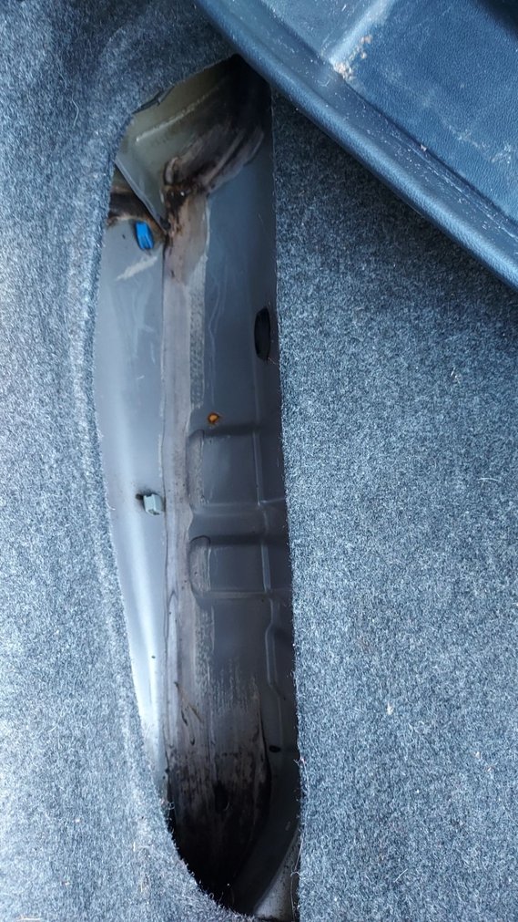

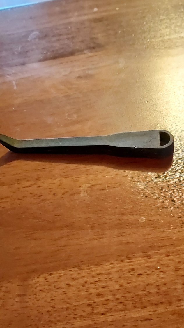

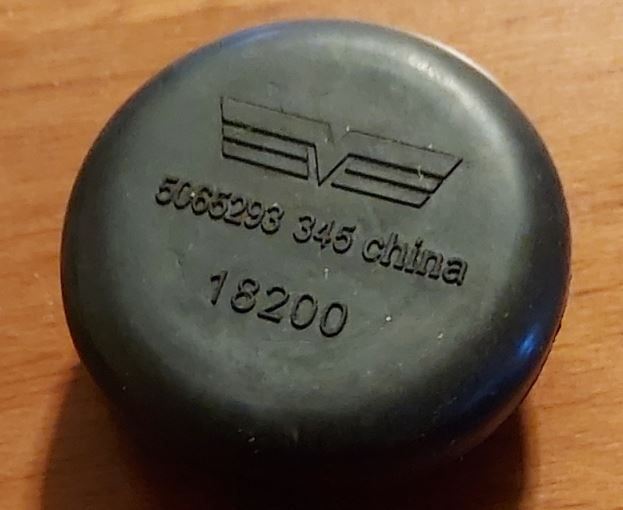

I'm having the same problem again, only the water is bulding up in the left side of the well. Lube-it-USA guy took out a plug on the side of the well, and dropped it, so he said "here is one of mine. Tell the auto store you neeed something like this to fit your car". I don't know how a plug can help drain the water in there. It's starting to smell like mildew. Is there a hose that is attached that dissappeared? They are not very helpful at this oil change place.
Your Amazon link doesn't work anymore. Can I see a picture of what you are talking about?
Old Jan 14, 2024 | 05:13 PM
The rear left side of the car has the cabin vent that is covered by the bumper cover. If a problem with the vent water can enter and pool in the side well. The grommet is on the right side wall of the well. Its the same design as those in the tire well. Assume the grommets are there to fill holes used to index the sheet metal part during stamp forming or assembling with other chassis parts. Once the chassis is made then no need for the holes.
The blue and white plastic clips at the bottom of the well attach something to the chassis.
Since the left side well no longer serves a functional task have at times drilled a small hole at the bottom to drain out water. To prevent rust have sprayed the well with something like LPS-3.
And check for debris around the chassis trunk rubber seal which could inhibit water flowing around the seal plus seal damage.

Change the word grommet to plug.
See link below.
https://parts.lakelandtoyota.com/sho...ey_model=15428

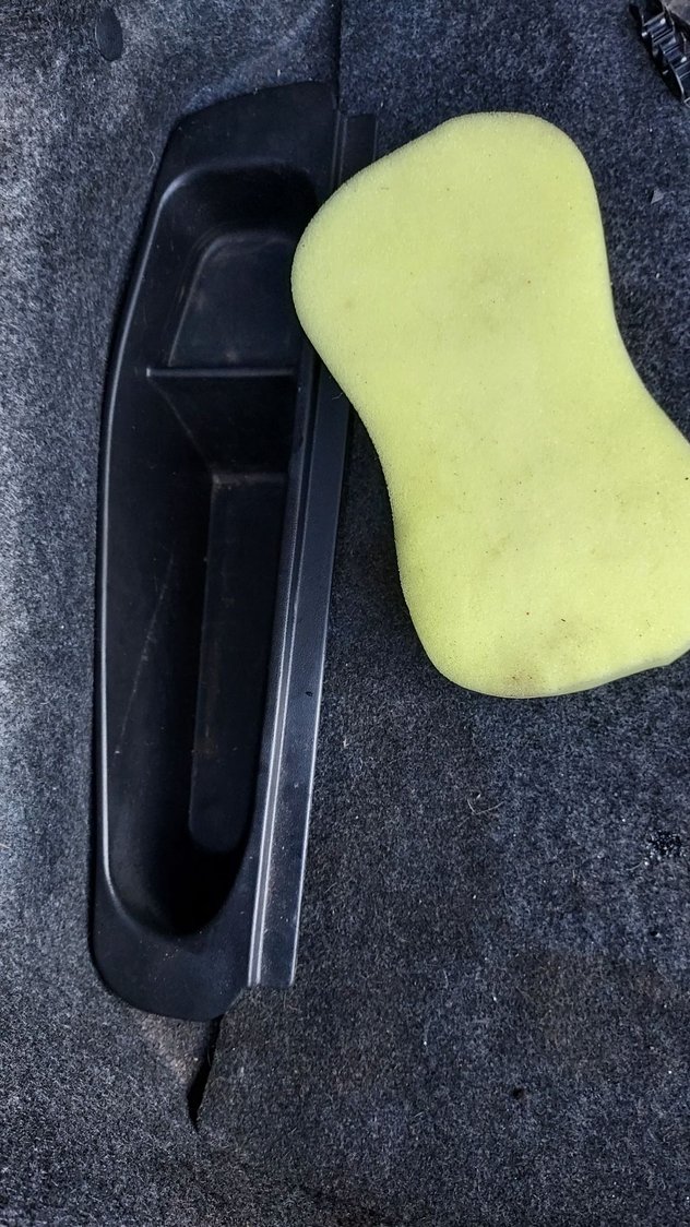

I still haven't resolved the water on the left side of my trunk well.
I looked on the right side of my trunk well, and found this thing. What the heck is this for? It has no writing on it.
