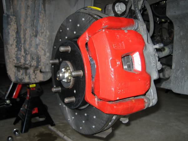

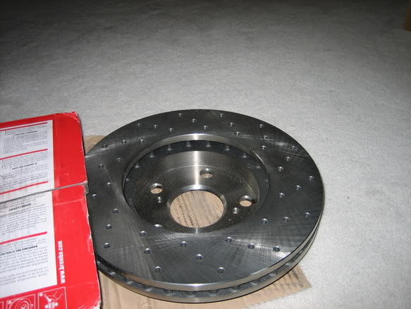

Heres a picture of the rotor before installation

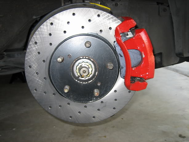

and after.
I only removed the calliper and the mounting bracket around it. Nothing else. You should notice that when you change brake pads that the disc will wobble, and if it doesnt, you just need a rubber mallet to tap it a few times and it should come loose. The OEM rotors are somewhat stuck to the axle sometimes.
