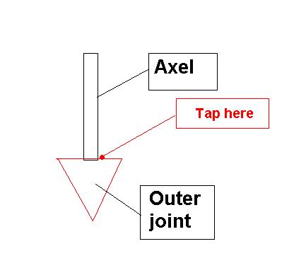

How do remove outer joint?

A friend of me said,
Se Picture: tap with a rubber hammer, and it will come of... If the car is old and full of corrosion, it may difficult to remove it.
When i change it, i can take some photos and post it.
Old May 21, 2014 | 10:33 AM
On some Toyota cars this is possible but not sure on Camry.
Consider the following procedure in the video below which may work better then hammering:
Please post back with photos!
