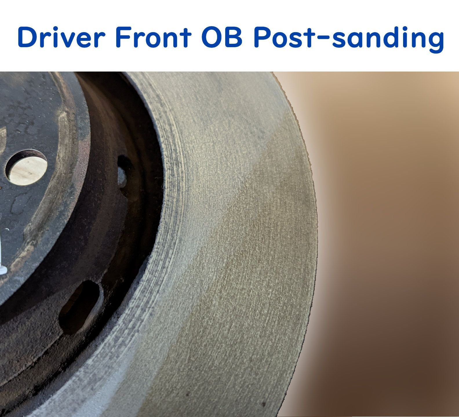

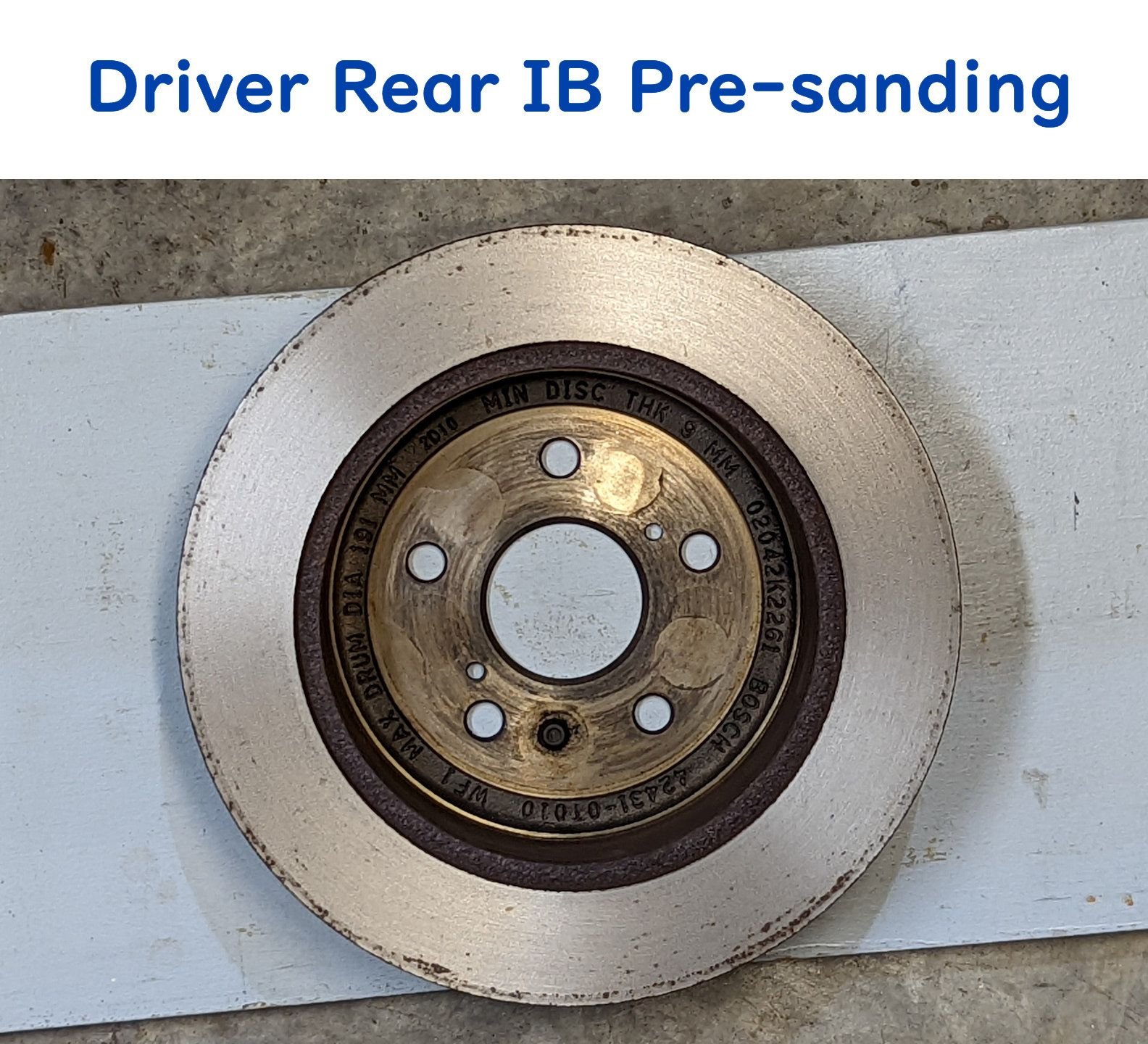

Today, after receiving my new Wagner OEX front and rear brake pads, I…
  • Retrieved the rotors from my Camry,
  • Noticed some rust, discoloration, and grooves in the rotors, and
  • Lightly sanded one or both surfaces of some of the rotors using 400 grit sandpaper and a cushioned sanding block in a circular motion with particular attention to applying uniform pressure in all directions.
Below are pictures of my rotors…
However, if you are interested in a more complete story, I have included what I believe are the relevant events and facts from the history of the car and brakes.

    • The pads were in what I thought was a good shape with relatively smooth surfaces, no discoloration or chips, and each pad showing even wear with thicknesses ranging from 6-8 mm (pictures available),
    • All of the rotors were grooved, the front rotors were grooved worse than the rear, and one side of one front rotor had what I consider to be deep grooves (pictures not available), and
    • Both rear rotors had an area of “severe acne” covering one-third of both the inboard and outboard surfaces, with the outboard surface worse than the inboard surface and both surfaces of one rotor worse than the other (pictures not available), and

Old Aug 7, 2022 | 01:26 PM
Posts: 15,178
Welcome to CF.
On rare occasions I have put new pads on FAR worse rotors then in your photos with no issues. As such assume your rotors should be OK. Rusted and grooved surfaces can be harder on a pad and effect its life.
Might research if this car (Venza) has poor braking as part of a design issue as some Toyota years and models did.
Suggest you inspect the brake calipers to make sure there is not a problem causing poor braking.
A caliper or caliper piston may be frozen. The calipers should be free to move sideways on its holder. The piston should move forward when the brakes are pressed.
DO NOT check for piston movement by pressing on the brake with the pads removed as the piston can pop out of the caliper. Have someone press on the brake while you watch the piston movement (pads installed!). In stalling the new pads the pistons will need to be retracted manually which will also indicate if it is frozen or can't move freely.
Bleed the brake system in case there is any air. The best would be to bleed to the point of flushing out all the old fluid.
You want firm brake pedal as in it becomes solid when pressed and doesn't keep moving lower and lower. Here look for possible problem master cylinder.
Make sure the power brake system is working. The car will stop with the power brake system not working but more pedal force is needed.
In conclusion. The rotors didn't clean up. Your choice is new rotors or use as is. I would use as is. Do check out the rest of the brake system for problems contributing to poor braking.
Old Aug 8, 2022 | 03:03 PM
JWKinRVA's Avatar
Joined: Mar 2022
Posts: 19
On rare occasions I have put new pads on FAR worse rotors then in your photos with no issues. As such assume your rotors should be OK. Rusted and grooved surfaces can be harder on a pad and effect its life. [Snip] In conclusion. The rotors didn't clean up. Your choice is new rotors or use as is. I would use as is.
I posted on other forums and visited two local brake guys. Only one poster recommended not using the newly turned rotors. Everyone else agrees with you... Use as is.
Perhaps more importantly, since the rotors were first resurfaced in 2019, most people thought resurfacing the 2012 OE rotors a second time last month was a bad idea and everyone agreed I should have spent $50 more and simply purchased 4 new rotors.
As a matter of fact, a good number of people said I should never resurface rotors and recommended buying new modestly priced rotors instead.
