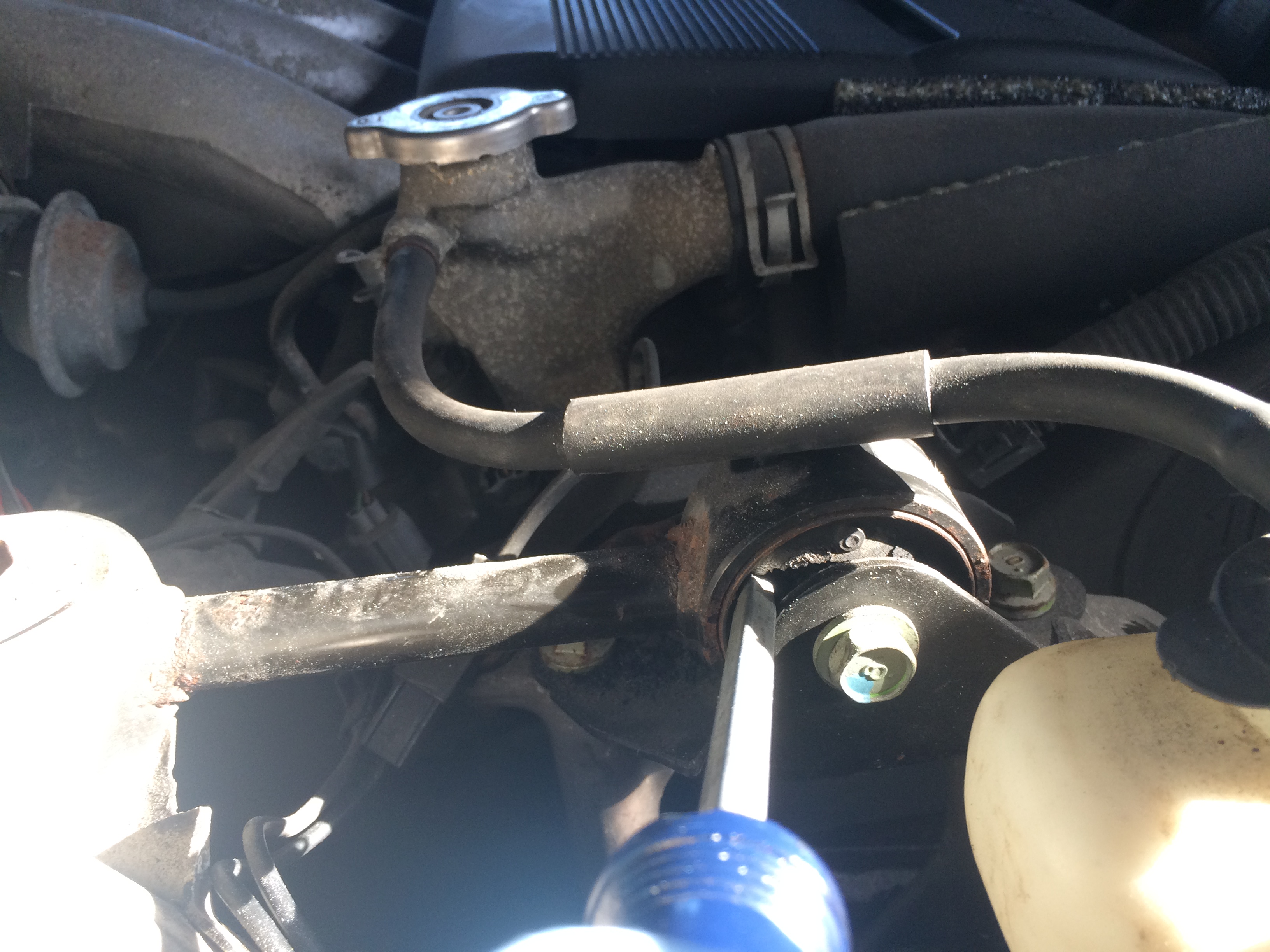

I have noticed a slight lurching of the engine.
I think my dog bone mount is shot.
I assume it has never been replaced.
I believe from You Tube if I have someone watch on the side of my car while I have the foot on brake in r or d it will show looseness. Will I see damaged rubber or anything by just looking at it.
Just want to make sure before I change the part.
It started once I began to use it as my daily driver and on the highway. Fast acceleration at times to get onto highway.
Old May 27, 2018 | 06:20 PM
wdc123's Avatar
Joined: Oct 2015
Posts: 425

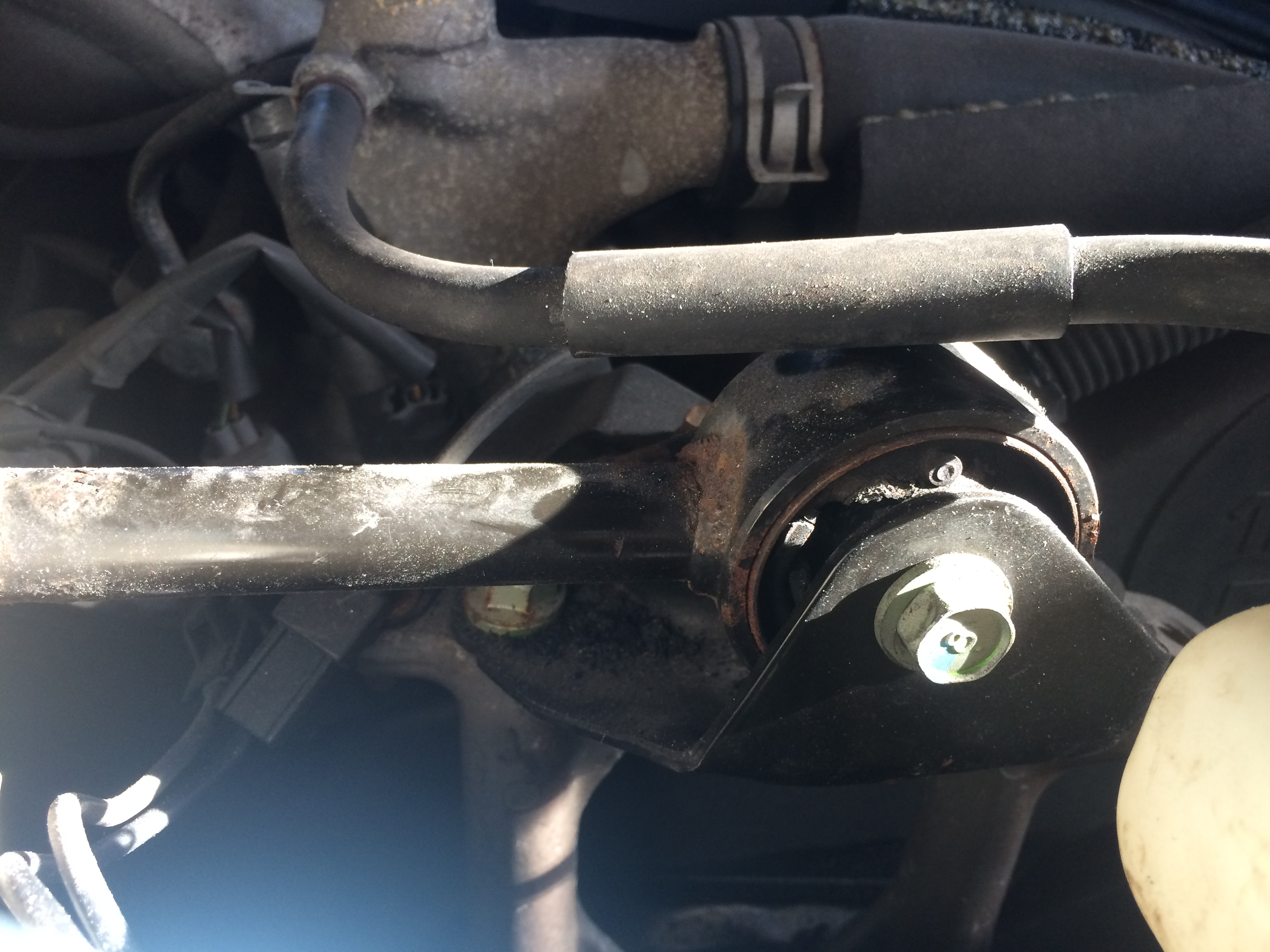

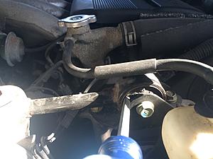

I am working on the car changing the oil and took a closer look. The bushings are shot as you can see the ease of putting a screw driver through it. No driving this puppy until fixed.
I will read the manual on how to remove / replace but should be straight forward?

I just installed the upper engine mount and works fine. Very easy to do. At least on my vehicle.
Old May 30, 2018 | 10:58 AM
Great job!
Thanks for documenting and posting your efforts.
