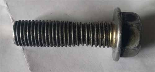

I got the tranny in and started torquing down the bottom three transmission to engine bolts. Torque in the manual said 34 ft-lbs. The long bolt torqued down fine but the other two shorter ones wouldn't. I got up to 30 ft-lbs and it wouldn't tighten down. I thought maybe something was stripped so I pulled one out and it looked fine but I probably didn't look close enough. I put it back in and it continued to not tighten down. I went to the second one and it did the same... and then broke off. Seems like it should take much more than 30 ft-lbs to break one of those bolts. I pulled the other bolt out and looked at it closer and it was stretched in the upper third. My only guess would be someone over-torqued them at some point and compromised the bolt. I just picked up a new digital torque adapter so hopefully it wasn't me. Curious if you have found issues in the past with toyota bolts having a history of showing abnormal fatigue at any point.

You sure the bolts are the right grade?

Here is picture of the bolt that didn't break.
Is it possible to get away with two bolts on the bottom, at least for now?
The one broken is the middle one of the three. I need to find a replacement bolt for this one and figure out how to extract the broken bolt at some point.
I don't know. They are the ones that I pulled out of the car. They have two dashes on the head, - - Apparently this is a class 6T bolt.
There is some info in the Service Specifications section of the manual, I am not sure what they mean by diameter. This bolt is 8mm if you don't count the threads. 9mm if you do. Looking at the 8mm diameters, only an 11T flange bolt would be torqued to 34 ft-lbs. The bolt has a 14 mm hex head with a flange. A 10mm 6T flange bolt would have a torque spec of 32 ft-lbs. If this is actually what is deemed a 10mm bolt, then maybe 34 ft-lbs would be OK?
