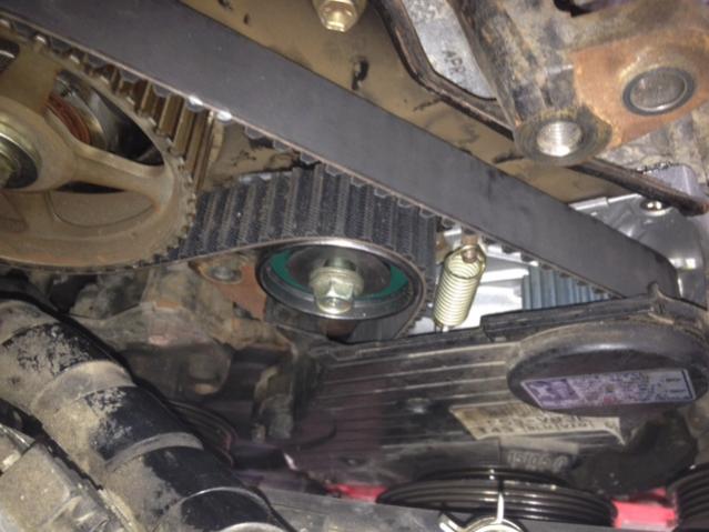

Default Green spring = different procedure?
Thanks again, Joey...Haynes seems to differ on a lot of things...Starting to not trust it as much as the forums.
Here's another question:
So both Haynes and the Dayco belt kit instructions state that if I has a "green idler spring" on the car, I need to time it differently than if it has a silver spring (a 45 degree crank difference!).
Problem: Kit came with two springs - One definitely silver, and one more like gold - calling it green would be a stretch. Of course, the old one that came off was also this more-gold-than-green color...It leaves me with just enough of a question to ask before I button it up and crank it.
Anybody? Is this more-gold-than-green color commonly referred to as "green"?
I'm dead in the water until I know.

All done thanks for the help guys. Next time will go a lot more quickly.
Regarding that damned spring: I just did what made sense: Crank TDC #1, Cam TDC compression #1. No idea what difference the tension springs make, but it runs great.
