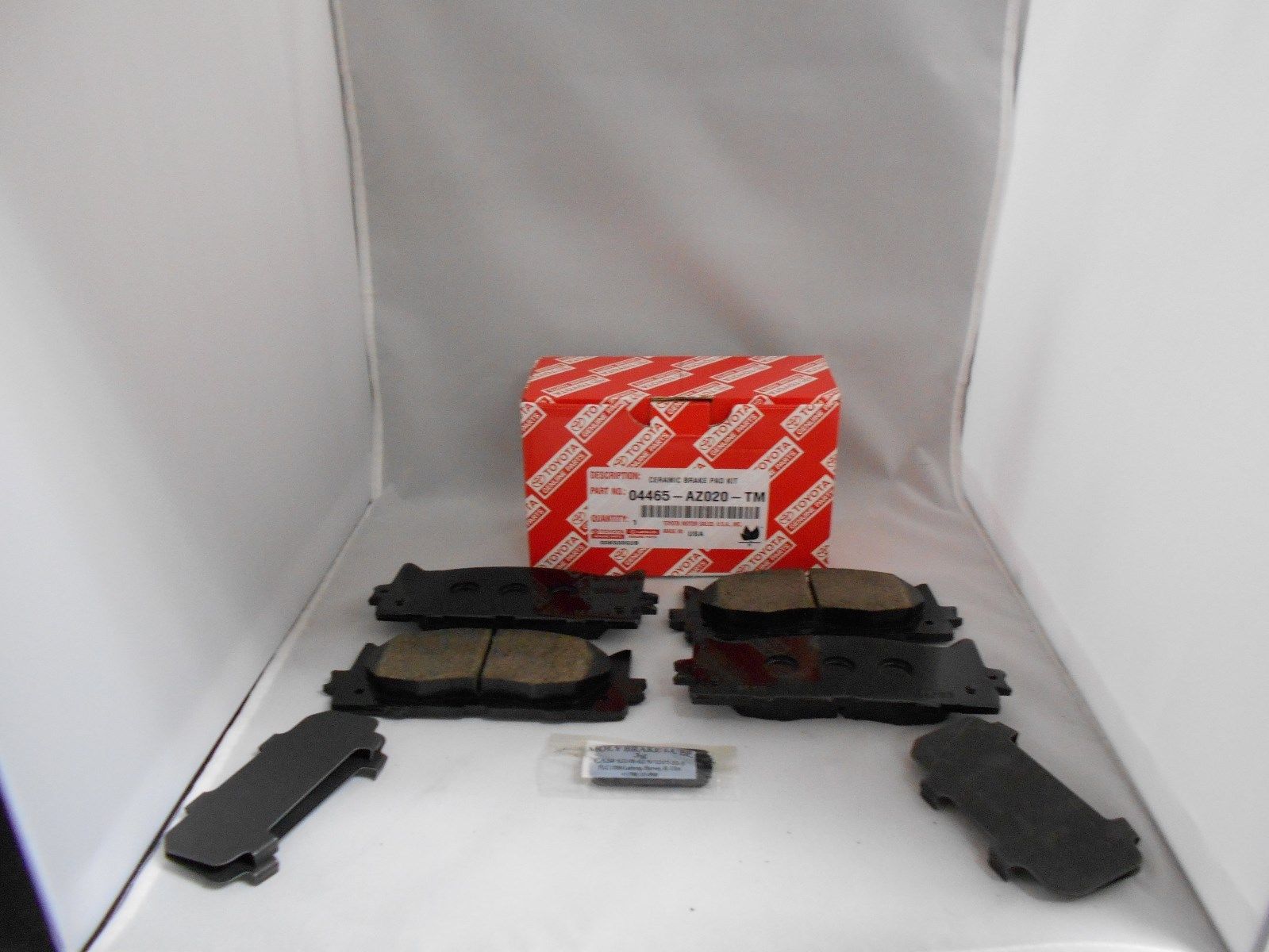

Genuine pads
2007 2016 Toyota Camry Genuine Front Brake Pads | eBay
Attached Thumbnails Bad Brake Job on 2011 Camry?-ceramic.jpg   Bad Brake Job on 2011 Camry?-2011pad-set.jpg
