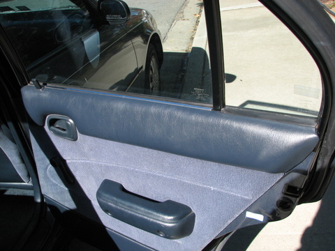

Hi,
"A" Dog ate my Trim but i am not sure what to call it in a search online for the part. I cannot find it anywhere in order to pull it out and replace. Does anyone know what search term i should use. Photo attached. I am just looking for the soft top part.
Thanks,
Moto
Attached Thumbnails A Dog ate my Trim - Camry LE 1993 Back door trim-corolla-93-le-back-door-trim.jpg
Old Dec 9, 2010 | 10:52 AM
Posts: 15,178
The top and bottom are one part, called a door panel.
The arm rest comes off by itself, the panel then pulls off. Try to find a used door panel. The odds of finding new replacement, factory or otherwise is slim.
Perhaps a shop doing custom car interior work such as seats or upholstery work may be able to repair or replace just the top portion.
