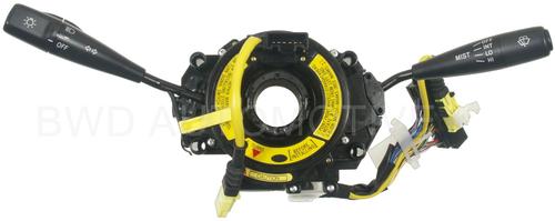

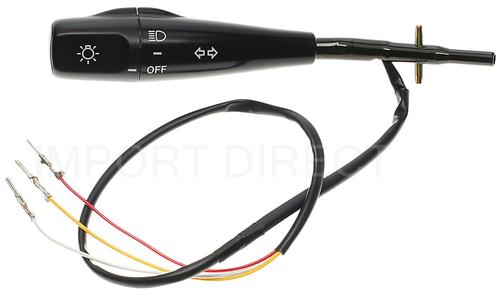

It's a 95 Camry Wagon. So are you saying the Wagon implements an individual headlight switch as opposed to being part of a combination switch, i.e., a switch which includes the turn signal, etc. vs. a single switch? See attached switch pics.

I understand that the switch is faulty. What I'm trying to clarify is whether I'll be replacing a single switch or a combination switch as in the pics I posted previously. I want to plan my time accordingly and want to know what I'm getting myself into. Thanks.

If the only switch that does not work is the high beam on/off, then this is the switch that needs replacing. This switch would be at the base of the light switch stem.
