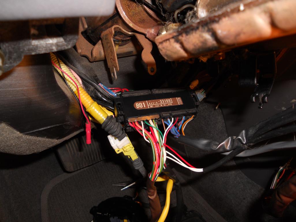

Okay, hoping someone can help. I replaced the old dimmer switch. All that's left is the de-pinning of the old switch leads & the pinning of the new leads. Attached is a picture of the connector, into which the dimmer switch leads (total of 7) are inserted. I picked up a terminal tool to ease the de-pinning process. Shouldn't this connector separate, giving me access to the male pin heads, allowing me to de-pin the connector? Also, at the top and bottom of the connector are flaps, which when lifted, allows access at the pin's point of insertion. If this connector does separate, how is that done?

There is a SMALL clip to push for each plug. Look on the opposite side of the label.

Okay, thanks for that. I've noted the wire color relating to each terminal. The terminal removal tool I picked up at O'Reilly's doesn't mate with the type of connector pin present. Any suggestions? When I do get these pins out, do the new leads simply push in by hand or is there a more precise way of re-pinning the connector?

Did you get the two plugs disconnected?
Toyota has a HOST of different plugs and pins styles. Look at the plug for any holes on the side or top that can allow tool access.
Most pins have a spring tab that can only be compressed from one direction, typically the front (opposite side of exposed wires) of the plug. Toyota may have some designs where it is compressed from the opposite direction.
If new switch has pins suggest reviewing their design as to how they lock in and can be unlocked.
For pin removal tools, Toyota also uses a narrow, thin, flat probe to remove some pin designs, almost like a thin but ridged feeler gauge.
Or a narrow, thicker, flat probe having a very long taper. The tapered end is inserted.
Would assume for this plug, the leads push in from the back of the plug. Other wise wiring the plug would be too complicated and time consuming.
