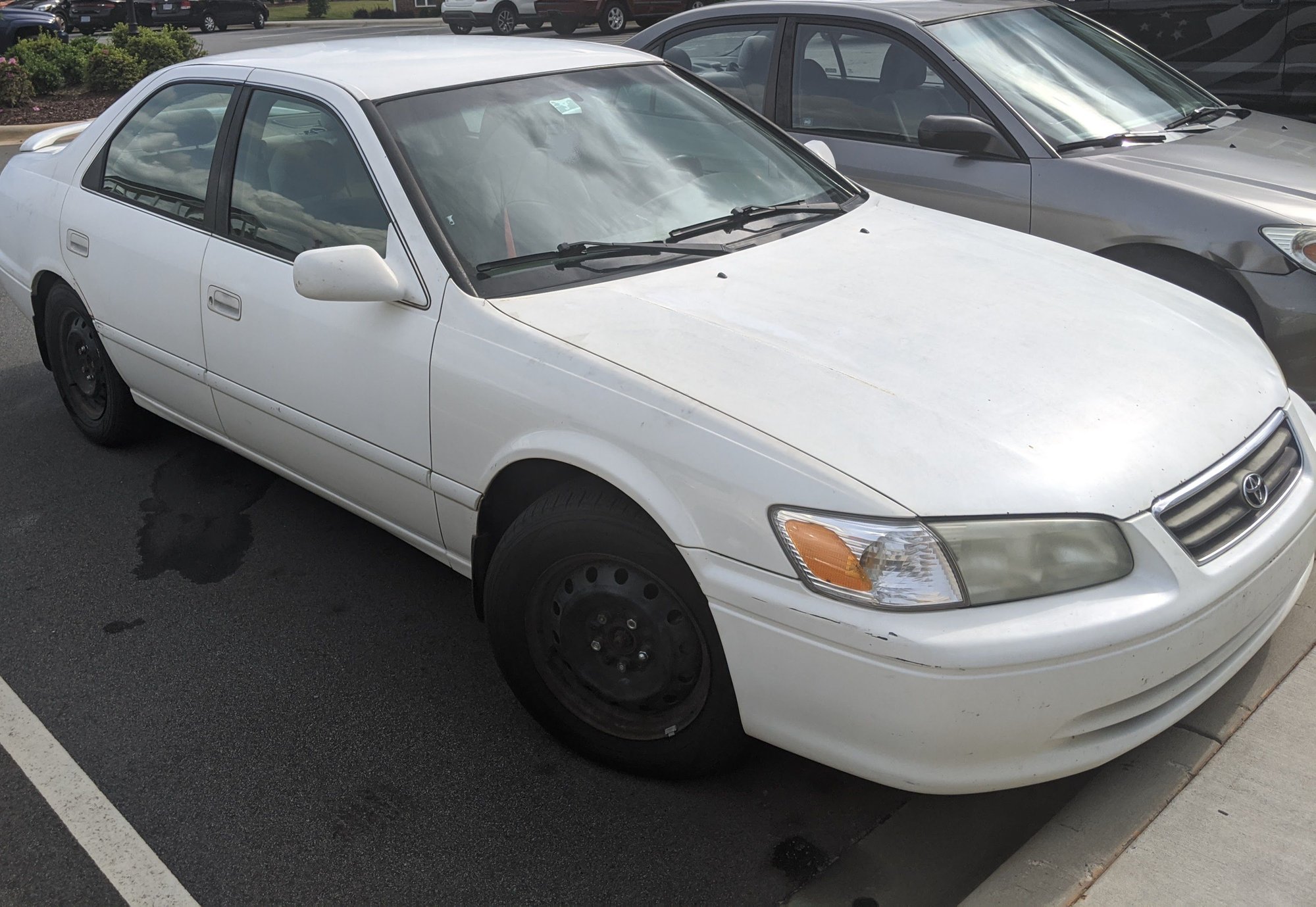

I have a 2001 Toyota Camry LE 4-cyl (5S-FE). 210,000 miles and it still runs great! I got it from my parents. It has new tires and an alignment done. They were really good about changing the oil on time but that's pretty much it. I was wondering what I can do to make sure it runs for as long as possible. I'd like to pass it down to my daughter in about 4 - 5 years.
I'd like to do most of the work myself, if possible. I went ahead and changed the oil myself. I was trying to decide between Purolator or Toyota oil filter and went with the latter.
This is what I have planned:
- Change the power steering fluid (Any ATF DEXRON III, per manual)
- Flush the brake system (DOT 3 or 4)
- New brake pads (Duralast Max)
- Coolant flush (PEAK OE Asian Red)
- New air filter (Toyota brand)
- Change transmission fluid (Toyota OEM?)
- Change differential oil?
The current transmission fluid is brown-ish. Not black yet nor do I see any metallic specs. I know I shouldn't do a flush but I think it'd be safe to do a drain and refill. Maybe I should also take the bottom of the pan off and make sure it's clean? I could replace the filter/screen as well since I'm there. I thought about letting the dealership do it since I know transmissions can be delicate but they want to charge around $200. There is so many different transmission fluids... I think I might just go with Toyota OEM so I'm sure it'll be totally compatible.
Is there differential oil on this thing? I thought that was only for trucks. If so, Is it separate?
I'm brand new to auto care. I figured it'd be a good hobby and it'd save me money. How does my list look? Is there anything else you'd add that you think I should do? Anything I should do different? I also plan on detailing the car inside and out. Here are some pics:
