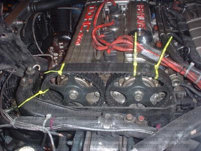

if you can get to the timing belt tensioner to slacken the timing the belt
try zip tieing the timing belt to the cams with a few zip ties
the timing belt might stay in place

Thanks again. The picture is a big help. I'm gonna try to do it this weekend.
