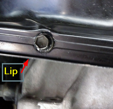

I have been thinking of the design of the pan for the transmission, and how it lends itself to a PITA to get to those 5 suck bolts that lie under the frame. The pan flares out at the edges for some reason that I can't quite grasp, creating a groove of sorts that the bolts line up in. On those 5 suck bolts, that means you cannot get a flush contact point on them with a wrench: you have to hit them at a slight angle due to that ridge. I don't have a ratchet/socket set that is shallow enough to work on those, so stuck using my ratcheting 10mm combo wrench.
Trying to figure out what would be the harm in grinding down that lip in that area so I could come at those bolts square on with my wrench. As long as I don't deform the shape of the pan by pressing down hard while grinding, why not? That lip has no effect on the seal, may be just there to protect the bolts from ground debris or something?

Old Apr 10, 2015 | 01:27 AM
  #16
The lip would provide more contact with the wrench or socket. However whatever works.

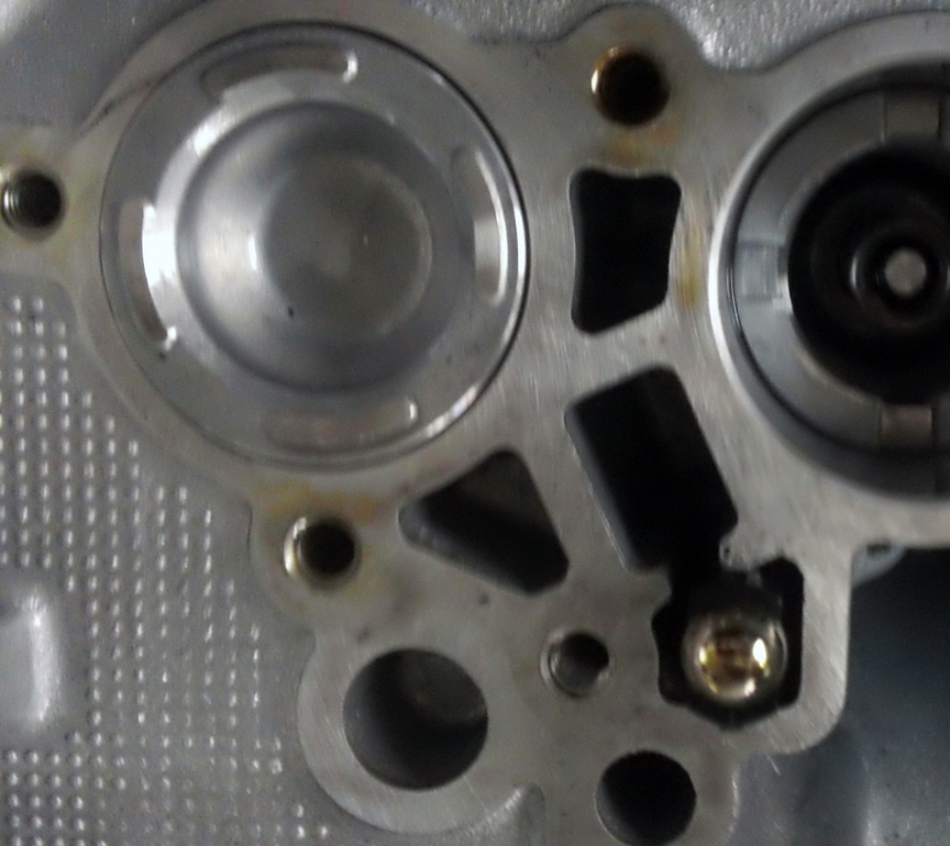

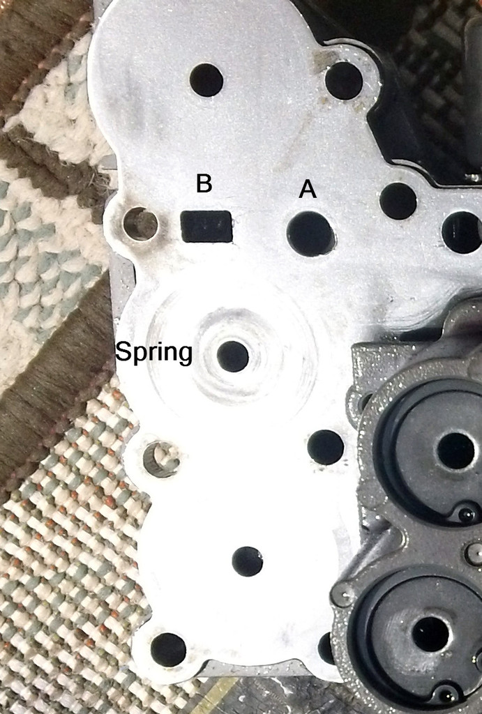

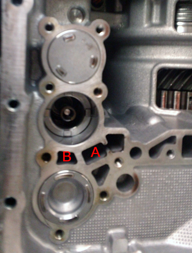

This is one of the worst illustrations in the FSM. The damn check ball body toppled out when lowering the valve body, so it is not clear to me exactly where it goes. Anyone know if it is the red circled area I have in this image? If so it looks like the ball side is up in this image, correct? Or does that thing go inside the spring?

On the inside (tranny side) of the valve body, I think that brass ball rests in what I have labeled A, right? Not B? And WTF man, talk about Mission Impossible. How do they expect you to get that spring and check ball body in? Nothing to lock into inside the tranny, and nothing on the valve body to hold it upright. Seems like I am going to need a small miracle to get this in, even with lifting the valve body with a jack.

Maybe this?

Old Apr 11, 2015 | 04:28 PM
  #18
Do you have a photo of the check ball body?
Looks like it installs in the hole to the right of "A" in the valve body photo (not cover photo).
Old Apr 11, 2015 | 04:51 PM
  #19
DIYDad's Avatar
Joined: Dec 2014
Posts: 156
From: Northern NM
The only place that makes sense is in the hole A. It doesn't fit in B, and in the photo above where I try to get it into that hole to the right of A it does not seat flush, so the valve body will not install. It flushes in perfect inside hole A, but there is nothing to hold it in place. I am stumped.
