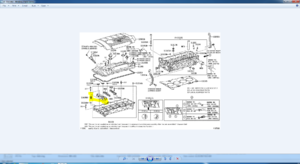

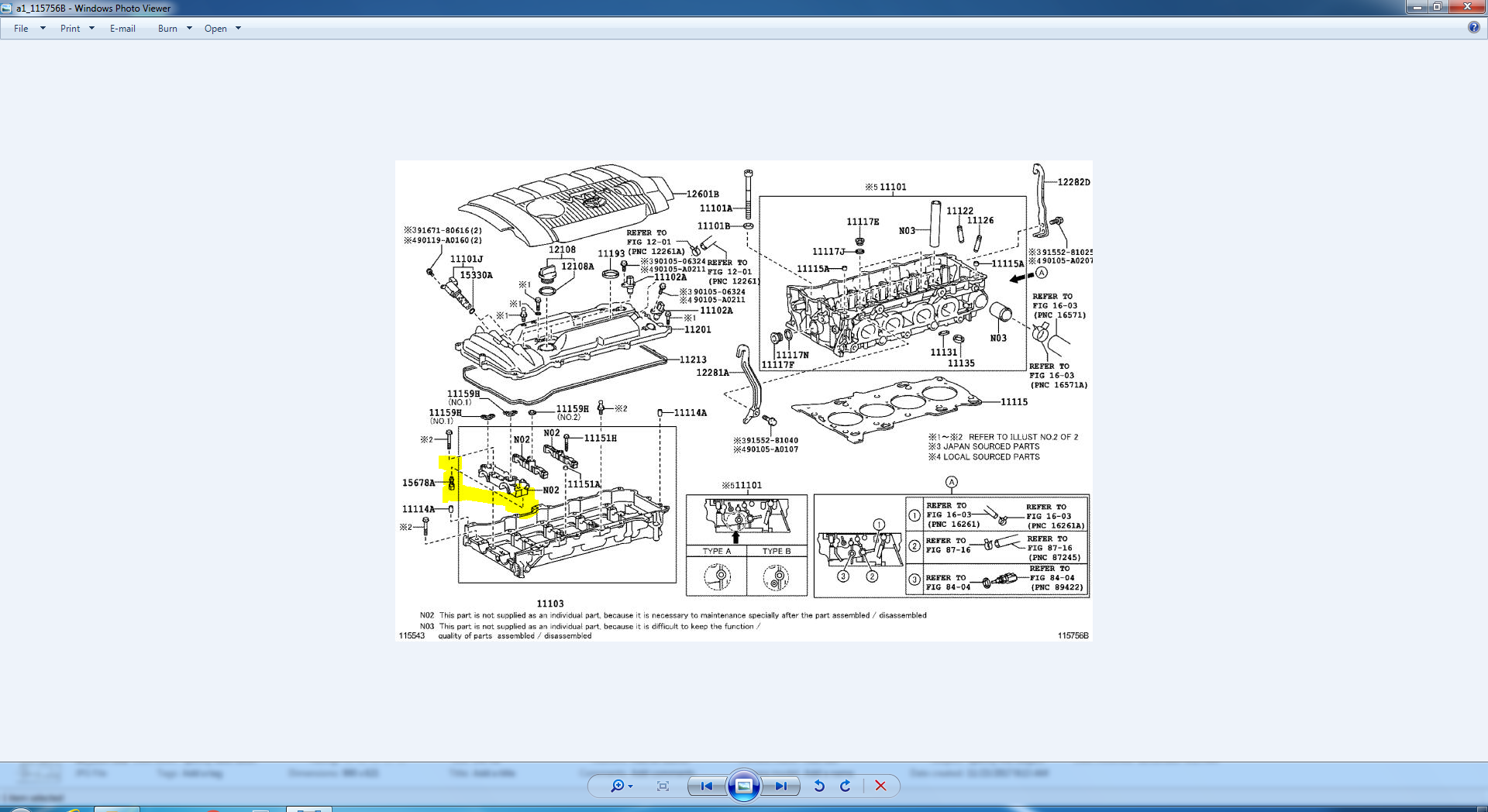

I have a 2010 Camry with 2.5l engine. I am wanting to replace the VVT-i oil control valve filter. I know it is under the valve cover but don't know where. According to the exploded view on the Toyota parts website it looks like it is under the cam bearing cap. Anyone replaced this before and can tell me if that is true? What am I getting myself into? Help! I replaced the oil control valves (they had trash in them) and I am getting intermittent P0012 codes. They will come on for a while and then go away only to come back later.

Thanks for the article. I have read that one twice. It doesn't show my application. My engine has dual VVT-i and the filter is under the head cover. The diagram on the Toyota parts website seems to indicate that the filter is under the cam bearing cap. I have attached the diagram with the filter highlighted. I believe I can do the job, but I need more info. I need clarity on exactly where that filter is. Do I have to remove the bearing cap or is it under a bolt?

Old Nov 23, 2017 | 02:25 PM
It appears the cap needs to be removed to access the filter.
Before removing, try to rotate the cams until the valve spring load is off the front lobes. This will limit bending loads when the cap is removed.
