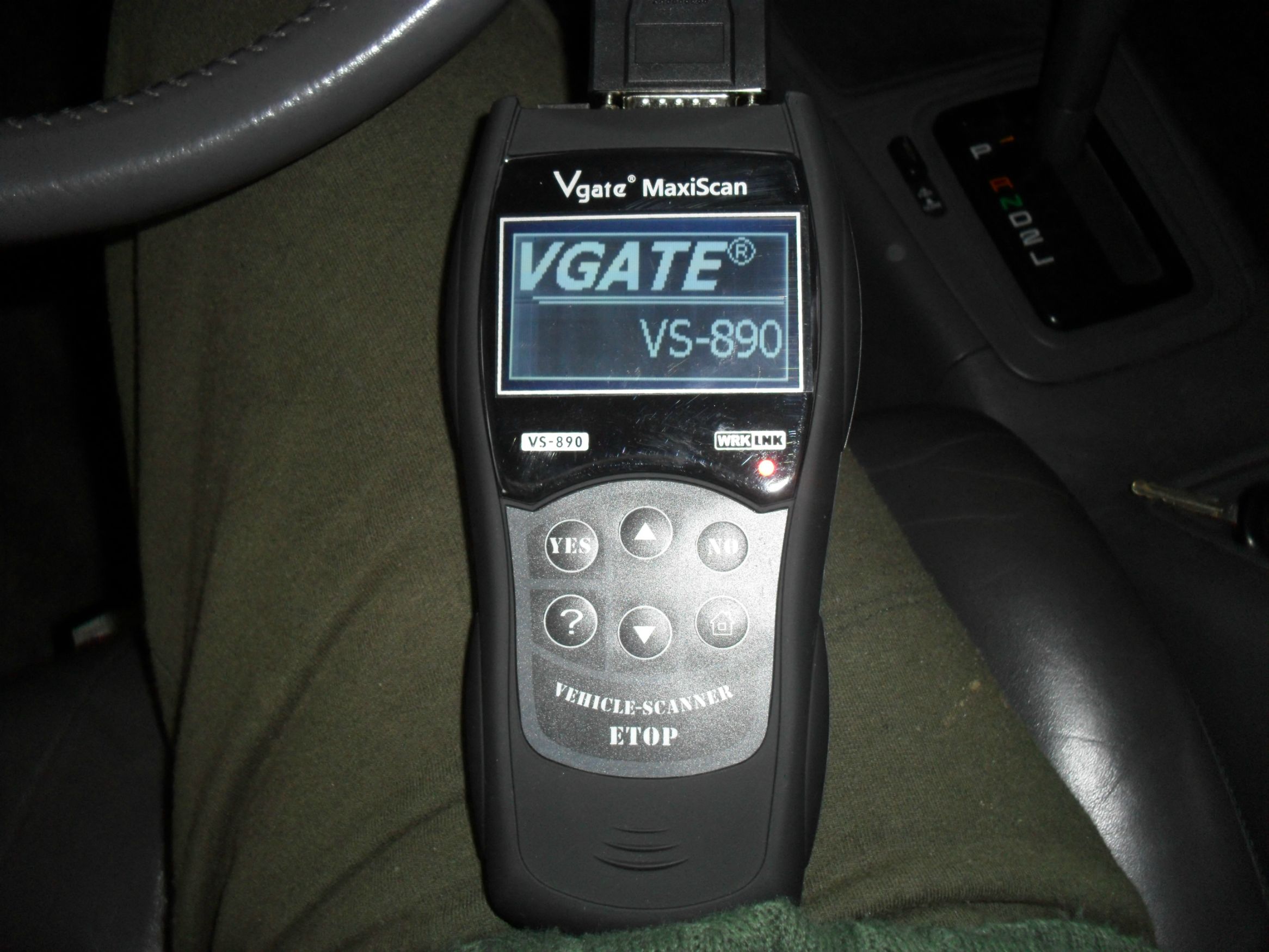

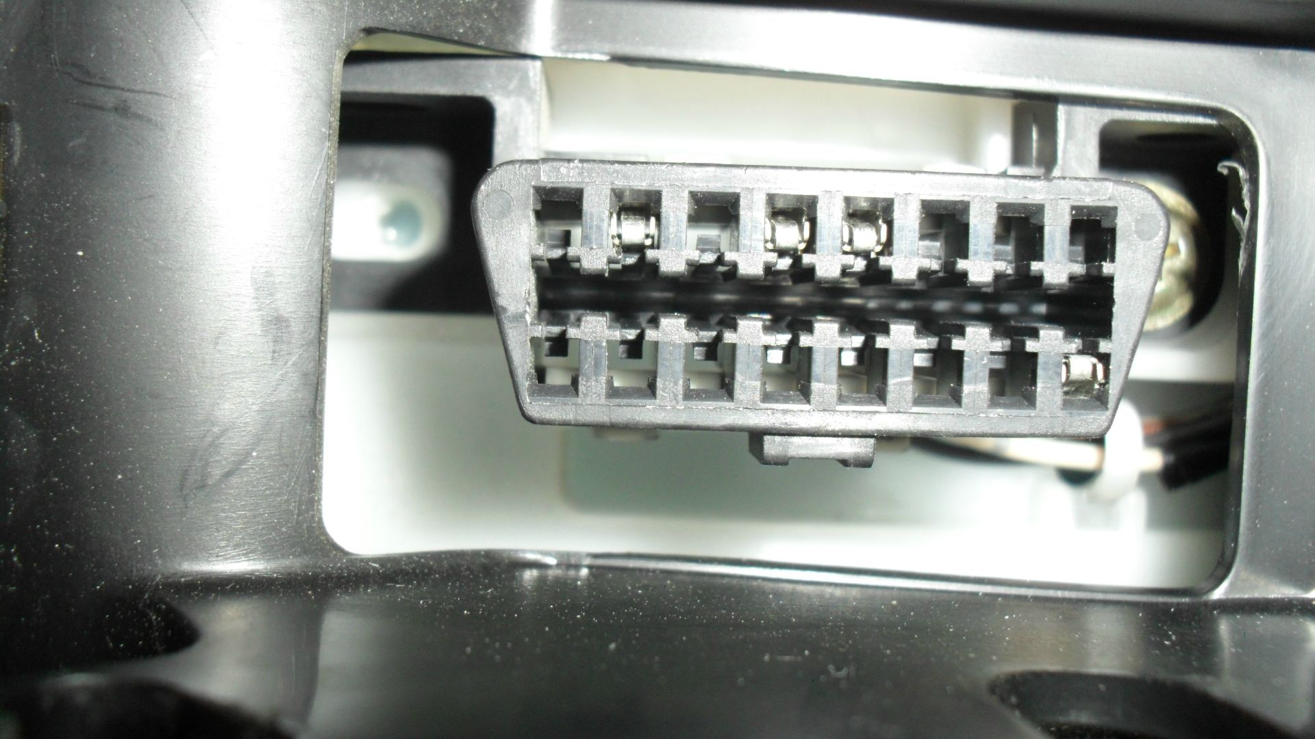

I have and 1995 Camry model, its build in 1994, XLE V6, I found out the OBDII conector under the dash, and seems he uses SAE J1850 VPW Protocol, som pictures:
I bought and Scanner on ebay called Vgate:
If you can see he start up normally, the problem is, I cannot make a link between the Scanner and the car, he says link error and dont lock on J1850 VPW protocol.
My doubt is if this car is really OBDII like some else says ahead or I have some problems with my scanner.

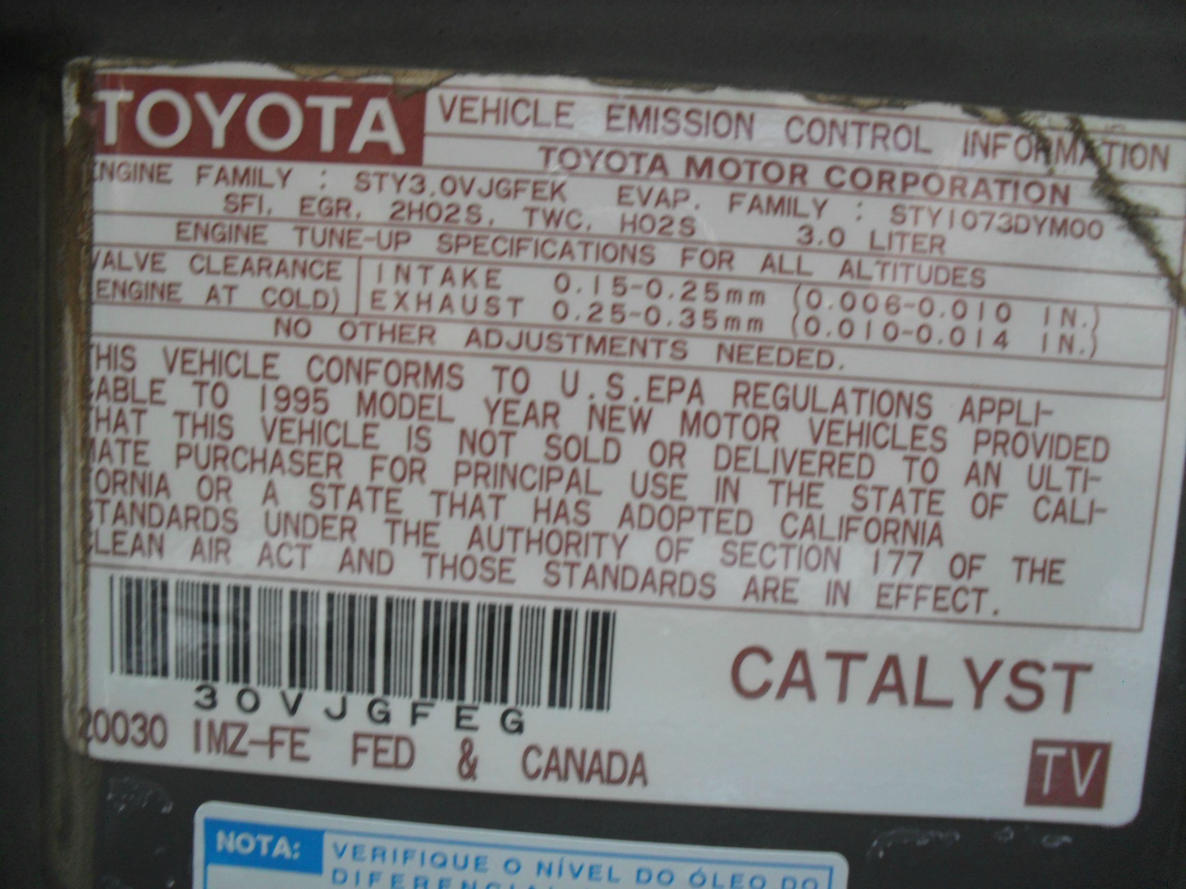

I tryed learn more about but came to dead end, cannot found out the real protocol used on my Camry:
