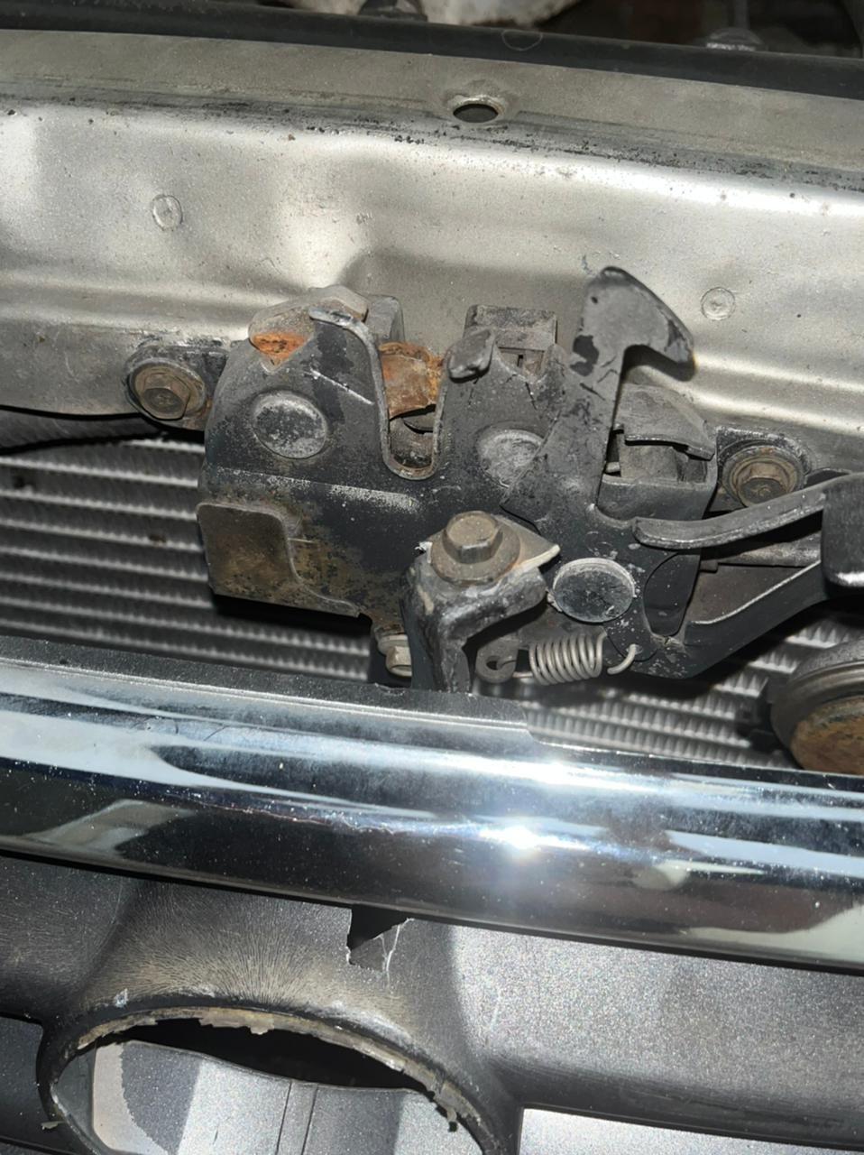

Can the hood be opened? If so open it and take a few pictures of the radiator area to post here.
The whole issue now is that the hood cannot be opened as it is jammed at the latch. Even I tried to slip my fingers in and was able to access and press the latch and I tried with my own strength but couldn't open. I even tried with the curved side of the hammer still no luck. It is jammed shut. Let me know if you have any ideas to open the jammed hood.

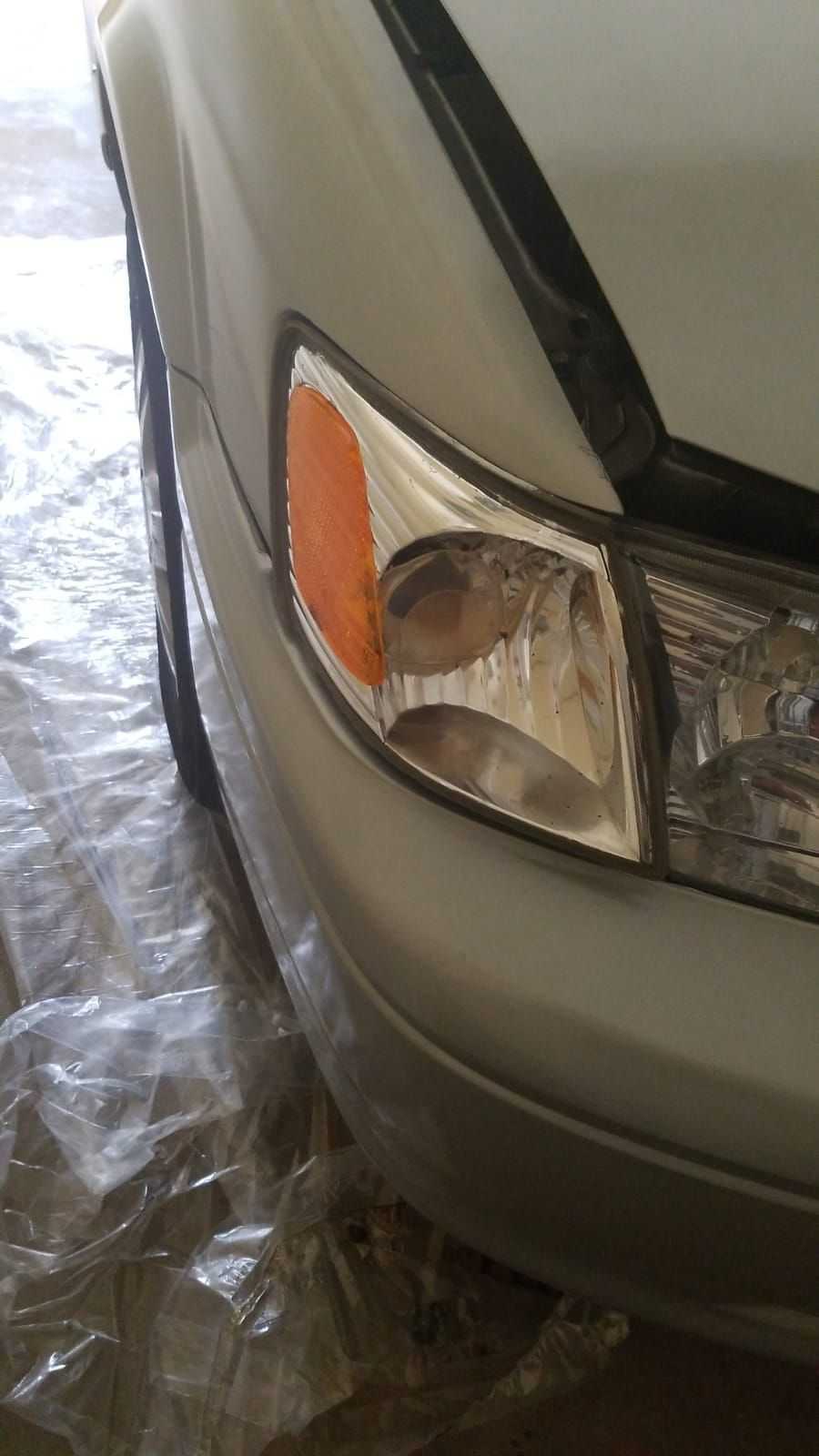

With my eyes, I see that the hood is damaged and the driver's side of the bumper is bulged out and the passenger side main light cover is broken (shown in the pictures attached now).
Bumper warped

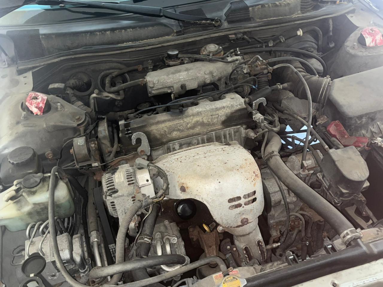

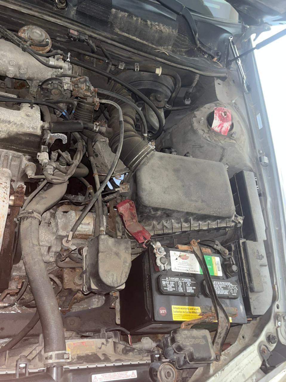

I, my wife and my 15 year old son who missed the school bus today did a lot of juggling and could able to open the hood. Struggled for 45mts and finally could open it. The hydraulics to hold the hood upright are not working so with one holding the hood up I filled 5 quarts of oil into the engine and also refilled the coolant as it was a bit low (not too low). After 5 minutes started the engine and the rattling sound was there for 15 secs and then it was gone. I pressed the gas pedal for 30 seconds and it seems it was fine but when I pressed the gas pedal a little further then I heard some different faint sound buried under the regular engine noise. I cannot explain what that sound was. Now I turned off the engine. Took some pictures and attached them here. Let me know what you guys think.
You have been very helpful. Please let me know what the next steps I should take to know if the engine is in good condition. Could the OBD2 device pick up any codes regarding the engine? If so let me know so that I'll buy this one from

Might be able to unbolt and move the hood latch parts around to make them now fit up. One can also shim the latch lower. Make sure the main hood latch and safety latch work. In a pinch have used a small diameter steel cable routed through the upper latch and lower chassis to make sure the hood stayed down. You don't want the hood popping up when driving!
Yeah, I don't have any metal wires or straps as I moved into this rental home recently and I can't go out to get one as I don't have a car. Can you suggest something from Amazon I can buy and get it delivered to accomplish this?
