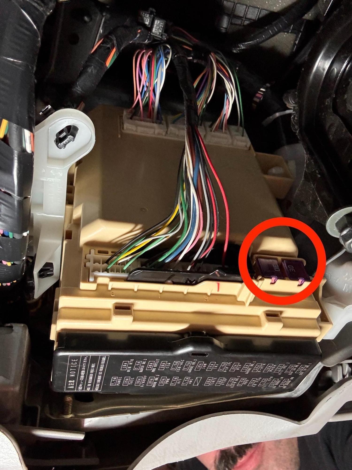

Actually I have a problem with a non user replaceable fuse which is not on the back of the cover, this is the a one of two bug fuses that might need to unscrew the box. Actually I need to know how to do it myself.

This is the best pic i could come up with for a 2007. Adding this in case it helps someone in the future. (There are others giving advice that it cannot be removed without dismantling the fusebox, and this isnt true.)

You can't remove these large body fuses without getting behind the fuse board.
Try Toyotanation.com
The fuse has a clear window to show the fuse element solid or burned through.
