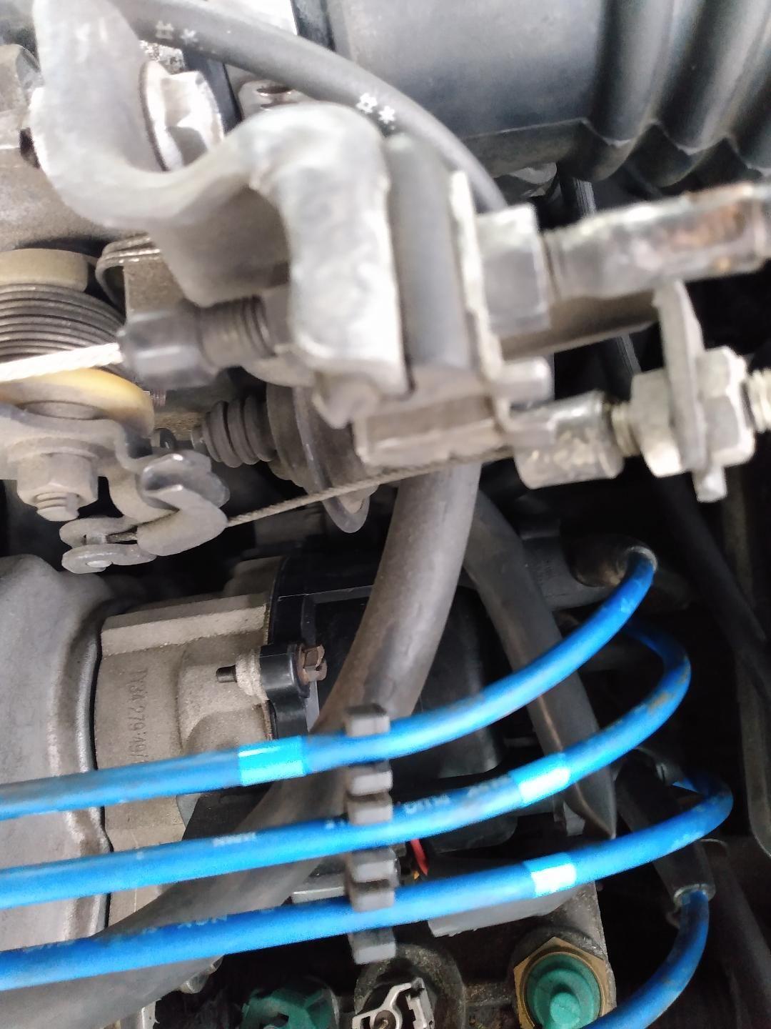

The only place I could locate a new PCV hose was eBay so I ordered one along with the accompanying valve and grommet.. it came today and seller states it is absolutely for my 1995 Camry LE 2.2.
Although I haven't torn open the new packages I did check the size against the one hose in my engine and it looks too small in circumference to attach to the top metal pipe and also doesn't look long enough.
I contacted the seller again with pictures and he insists it will fit and that my original hose has expanded through wear. (it will have but that much?)
I have added here pictures of my engine and that area, along with pictures of the new pieces whereby the new hose looks like it will fit the new valve and grommet but not the current one in use..
I hope someone can please verity the new parts WILL fit and if so, whether there is indeed a way- perhaps softening the new hose somehow first -- to attach the new hose and then the other parts.

Hello again.
After a long time of rough idling issues with my 1995 Camry, within the last few weeks I replaced the spark plugs and distributor cap and rotor. Nothing changed much.
However on Sunday when driving, the car suddenly stalled without warning and check-engine light came on. We were far from home (this has never happened before) but thankfully it started up again after a few minutes and got us home. I thought it had corrected itself so
Monday drove off and same thing happened. Monday afternoon I installed a new PVC valve, air filter and lightly cleaned the EGR system which barely had any build-up, unfortunately when backing out afterwards to test drive it it stalled.
Took it to a mechanic today and he found all was working well except the distributor! Had to have it replaced with a new one. It now drives well. The mechanic said the revs were really high but I have no clue why. He lowered them.
Below is a picture of the idle speed I took on Monday before the distributor was replaced.
We'll see how it goes.
Thank you for all your help.
