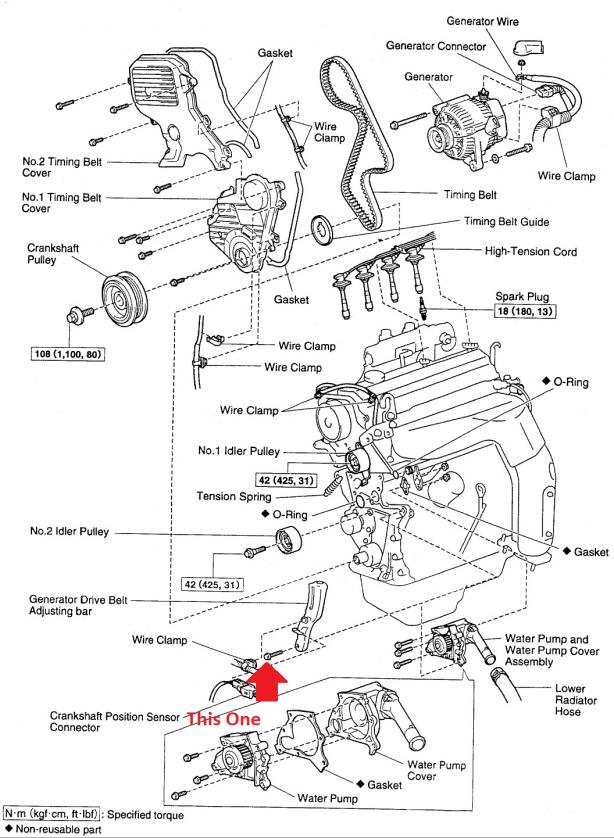

i need the specs for the bolt that goes through the lower alt bracket and through the waterpump into the block

what engine specs? year, model, etc

16 ft lbs
