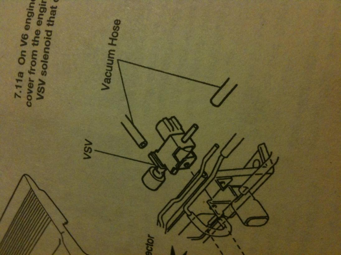

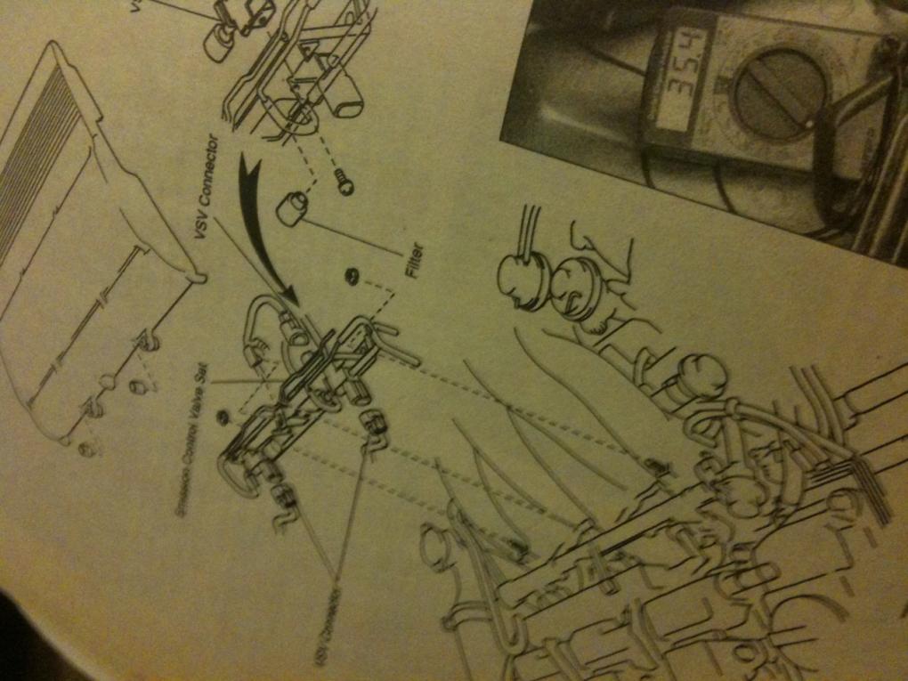

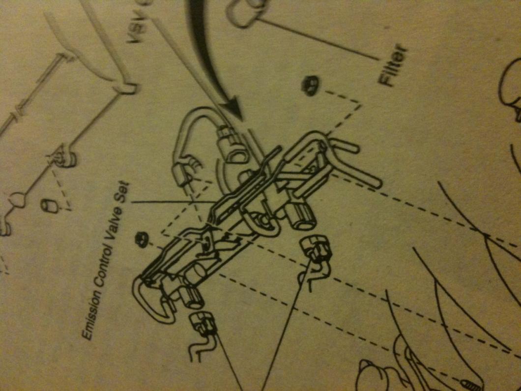

My Hanes repair manual shows 3 VSV on top of my 3.0 V6 engine like in picture..am I reading this right?

Any Ideas? Here are pics from manual.

The VSV is an electric solenoid controlled valve for vacuum lines. Many systems use a VSV such as emissions for the fuel tank and EGR valve.
Thus your car has more then one VSV.
Which system are you working on? Follow the vacuum lines from each valve to the device attached to such as EGR system or emissions canister. The valve will operate that system.
